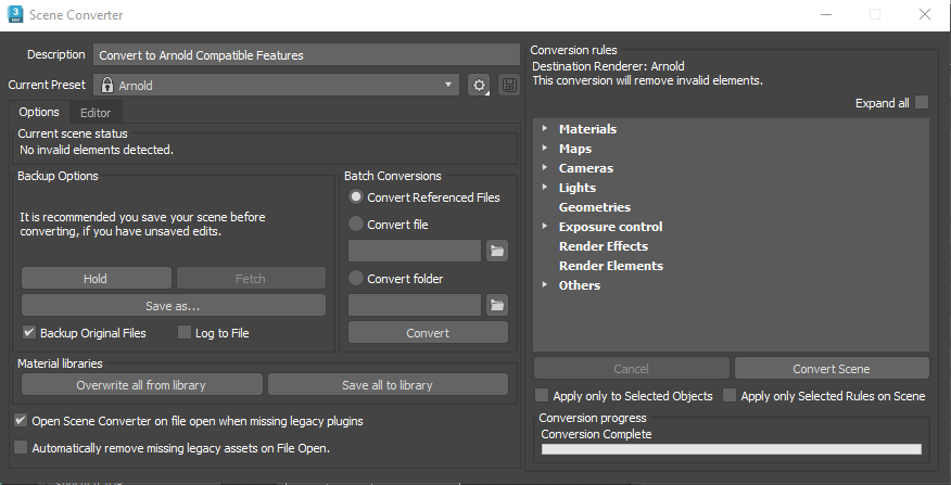

Rendering > Scene Converter
When you open a V-Ray scene and open the Scene Converter, 3dsMax automatically loads the Arnold preset file. The Arnold preset includes scripts that convert scene elements such as lights, shaders, maps, and materials. Note that you could also do this conversion through scripting.

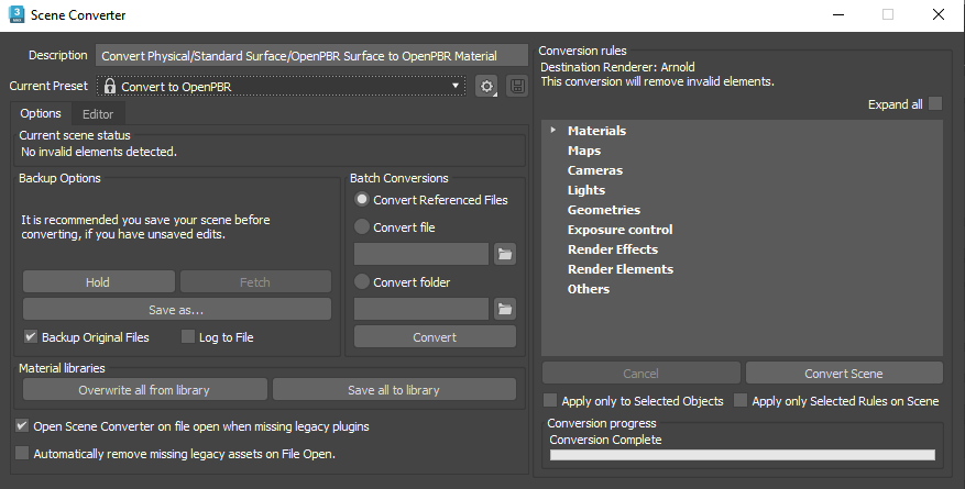

A Convert to OpenPBR preset is also available, which converts from Physical material, Arnold OpenPBR, and Standard Surface to OpenPBR Surface.
