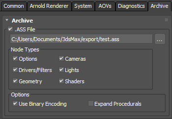

Exporting to .ASS by Rendering
MAXtoA lets you save scenes to .ass files that can later be rendered outside of 3ds Max with kick (a multi-platform, command-line utility) or used for rendering via Procedural.
  • From the Archive tab, select .ASS File.
  • Choose where you want to save the .ass file. When you next render the scene, MAXtoA will save an .ass file to the file path that you chose.
'Export to Ass File' in the System tab of Render Setup
Exported .ASS files done in this way are more suitable for rendering with kick or on a render farm.

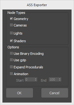

Exporting to .ASS from the Export menu
You can also export to .ASS from the file menu. Choose File -> Export -> Export... and pick "Arnold Scene Source (.ASS)" from the file type menu, which also allows you to only export selected objects.
The files exported in this way are more suitable for use in procedural objects, since no render options are exported, and by default, only geometry and shaders are.
