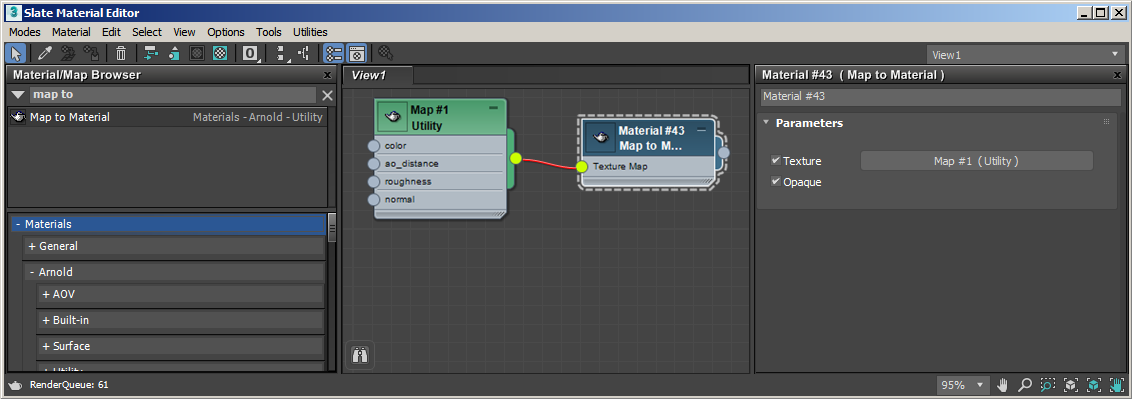

Map to Material can be used to assign Map shaders (that are not closures) from the Arnold 'Maps' group in the Slate Editor directly to objects in your scene. It can be found under Material/Map Browser-> Materials-> Utility in the Slate Material Editor.
Utility Map -> Map to Material
