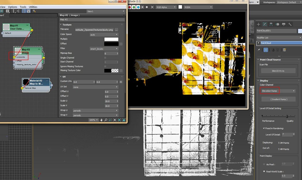

To pull these data into the material editor, you want to use a user_data_rgba /RGB/float shader, depending on the data type, with the Attribute string set to colors, and connect it to the shading node of your choice.
The Gradient Map is not supported. However, once in Elevation Ramp mode, you can use the user data output to drive any shader with support for input coordinates.
Here is an example of how to apply an image shader along the point cloud XY planar space. Note that the user_data_xxx shader will always perform the type conversion automatically (RGBA to UV in this case)
