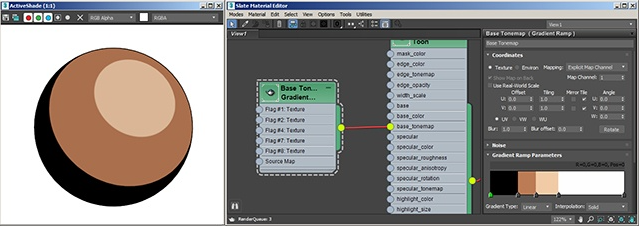

Gradient Ramp (solid) -> base_tonemap

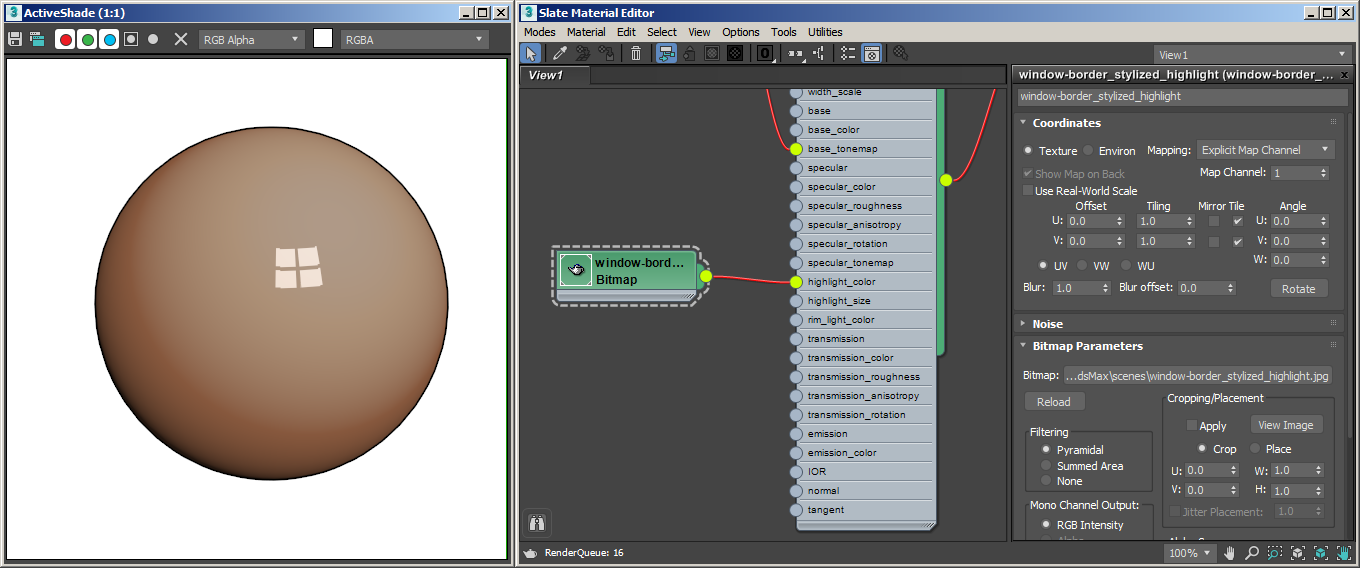

Window bitmap -> highlight_color

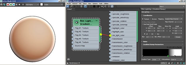

Effect of gradient on rim_lighting

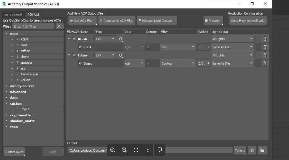

RGBA (box_filter) and edges custom AOV (contour_filter)
