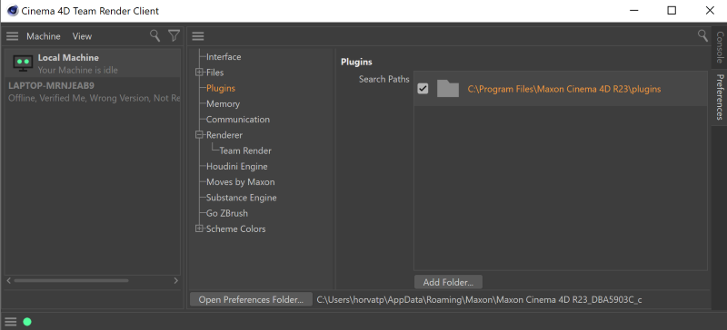

There's a known bug in Cinema 4D R23.008 , that plugins are not loaded automatically in Team Render Client and Commandline render. The plugins folder (e.g. c:\Program Files\Maxon Cinema 4D R23\plugins ) has to be added manually.
In Team Render Client go to File -> Preferences... -> Plugins -> Search Paths -> Add Folder...
For Commandline, specify the g_additionalModulePath environment variable.
