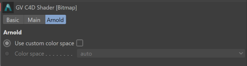

Custom color space option in the Bitmap Shader : Custom Arnold specific color spaces can now be set on a Bitmap Shader in the shader network editor. (c4dtoa#2426)

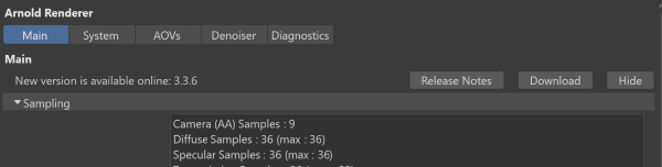

Release notes of new plugin versions : New button is added to the notification in the render settings when a new plugin version is available online, to open the release notes in the browser. (c4dtoa#2449)
