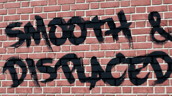

Various normal types for triplanar: The triplanar shader has a new parameter
normal_type
which can be used to select the type of normal to use for selecting the dominant axis for texturing. The options areshading
, which is the previous behavior and uses the smooth shading normal (this normal includes bump),smooth_and_displaced
is like the shading normal but without the bump, and finallysmooth_before_displacing
gives the smooth normal before displacement and bump. Note thatsmooth_before_displacing
requires that autobump be enabled. (ARNOLD-15523)
