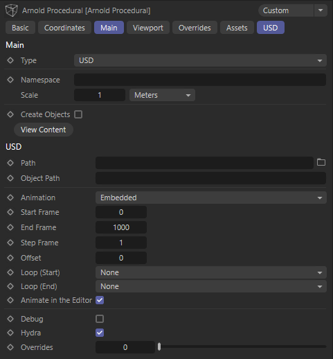

Path
The path to the USD file.
Object Path
Determines which USD primitive(s) are rendered. When empty (default), it will render the whole USD file.
Animation
Specifies how animation is written to USD files.
  • embedded: A single USD file contains all keyframes of the animation. That's the most common use case.
  • file sequence: In case of exporting animation to USD from the Arnold Scene Export dialog, the animation is written to a file sequence, which can be loaded in this mode.
Start Frame
First frame of the animation when a frame sequence is defined.
End Frame
Last frame of the animation when a frame sequence is defined.
Step Frame
Frame step of the animation when a frame sequence is defined.
Loop
Defines how the animation is repeated before and after the active frames.
  • none: No repeat, nothing is displayed before/after the animation.
  • freeze: Keeps the start/end frame rendered when moving further on the timeline.
  • repeat: Repeats the animation from the beginning.
  • ping pong: Will animate forward, then in reverse, then forward again, and so on.
Animate In Editor
When enabled, the procedural is animated in the viewport. Note that this requires reading geometry from the Alembic file in each frame, which can slow down the playback.
Debug
Dumps verbose logs about the USD nodes being created.
Hydra
Uses Hydra to handle the translation of USD to Arnold, which makes the render consistent with the Hydra render delegate.
Overrides
Serialized changes to be applied on top of the USD file, in USD ASCII format.
