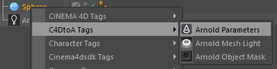

The Arnold tag (Arnold Parameters) is designed to assign special Arnold-related settings to the supported native Cinema 4D objects, such as the Polygon object, Light, Hair, etc.
The tag adapts to the underlying object, which means it dynamically displays the parameters defined by the type of the assigned object. If you add the tag to a polygon object, it will display parameters for the Arnold polymesh node. If you add the tag to an Omni Light object, it will display parameters of an Arnold point_light node, etc. If you don't see any parameters, it means that the object is not supported by C4DtoA directly.

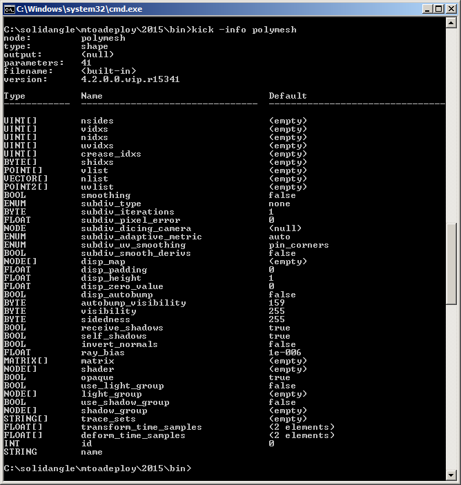

You can query the list of parameters of an Arnold node by using kick. For instance, if you want to change a polymesh option, you can get the attribute names by running:
kick -info polymesh
List of 'kick -info polymesh' available through Kick
Always refer to the core Arnold nodes and not to the parameter name as exposed in C4DtoA.
