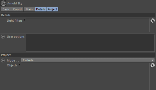

Light filters can be added to the Arnold Sky, and light linking can be set up like in any other lights.

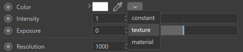

Color Texture
To use a texture map as the light color, you must change the mode of the color parameter to texture or material.
In texture mode, you can load an image as a native C4D texture (Bitmap shader). This mode does not allow the use of an Arnold shader network.

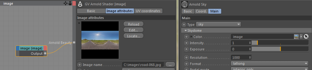

In material mode, you can create an Arnold Material and drag & drop it to the color field. The root of the shader network has to be a texture-type shader (e.g., image).
