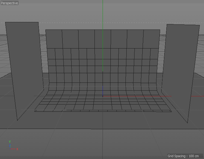

The scene consists of a curved backdrop with a floor plane and one plane on either side with a dark gray Standard Surface shader assigned to both of them.

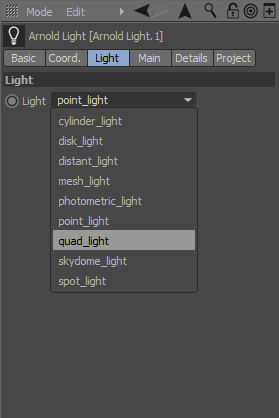

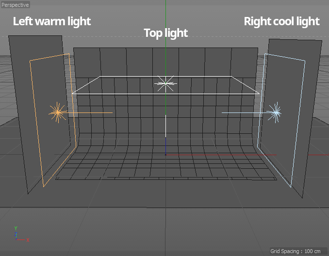

- Create an Arnold Area Light (quad) for each of the three light positions - top, left and right (Plugins > C4DtoA > Arnold Light > quad_light). These will represent large softboxes as used in a photographic studio.
Change the light type to 'Quad' for each of the lights
To achieve a simple and quick colored lighting effect, you can change the Color Temperature of the lights. In this case, the scene's left light has a warm temperature (3500), and the right light has a cool temperature (6500).

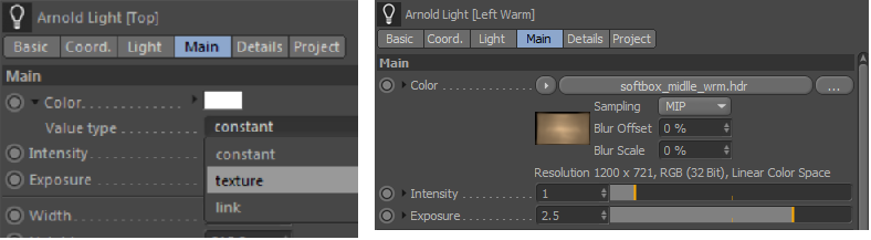

- Connect each HDR map to the color attribute of each area light as indicated in the images below:
| softbox_square_gs.hdr connected to Color attribute of Arnold area light 'Top' | softbox_midlle_cold.hdr connected to Color attribute of Arnold area light 'Right' | softbox_midlle_wrm.hdr connected to Color attribute of Arnold area light 'Left' |
Select the light, expand the Color attribute and select texture from the drop-down menu.
HDR map connected to Color texture attribute of left warm light

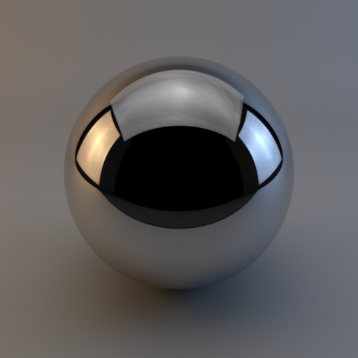

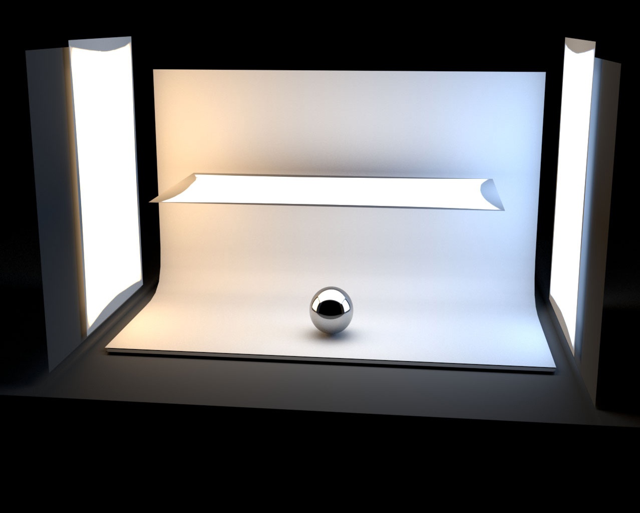

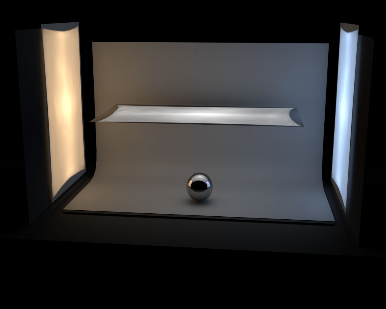

- Test render the scene. You should get something like the image below. If the reflections appear too bright, remember that you can lower the exposure settings in the Arnold attributes for the render camera.

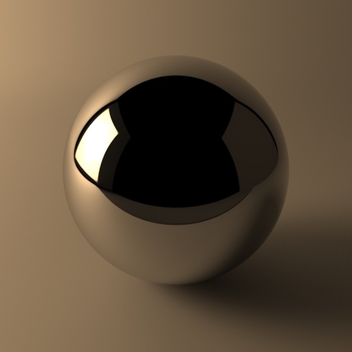

The high dynamic range of the HDR maps are visible when the lowering Arnold's camera exposure attribute

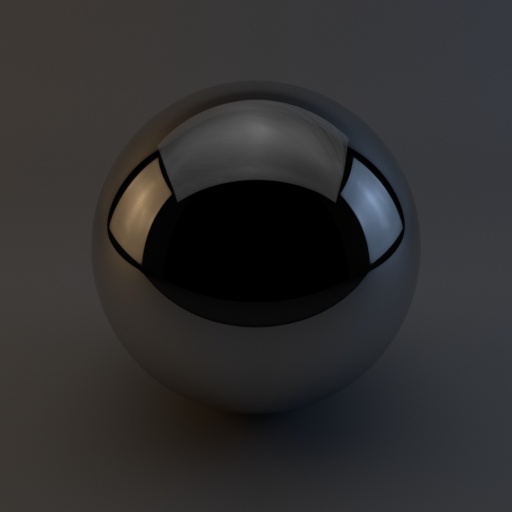

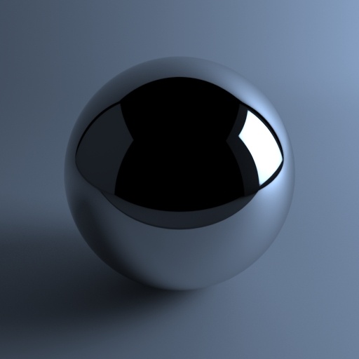

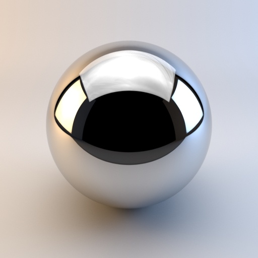

The light HDR map details are visible when lowering the camera exposure. You can see the full high dynamic range visible within the specular reflections in the scene:
| Exposure: 0 | Exposure: -2 | Exposure: -4 |

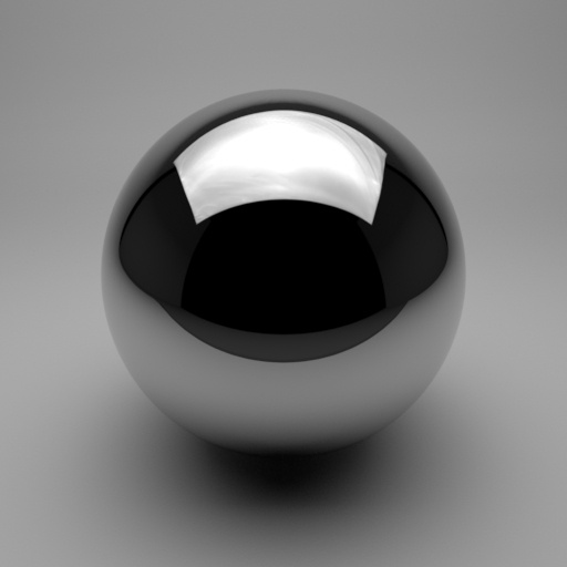

Spherical Camera Lens

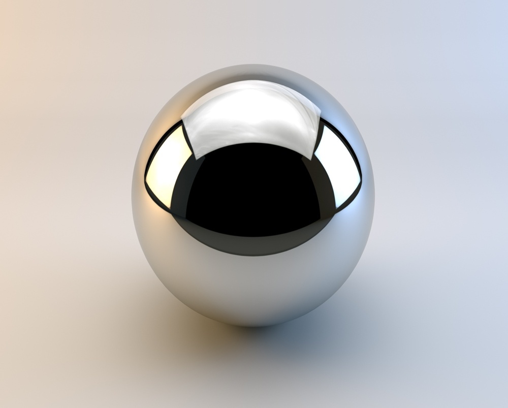

Once you have completed this tutorial, why not have a go at converting the scene into an HDR map using the spherical_camera lens.
Scene rendered with Spherical Camera lens
