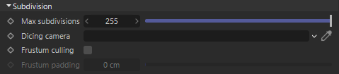

These settings control Arnold's tessellation of subdivision surfaces.
Note:

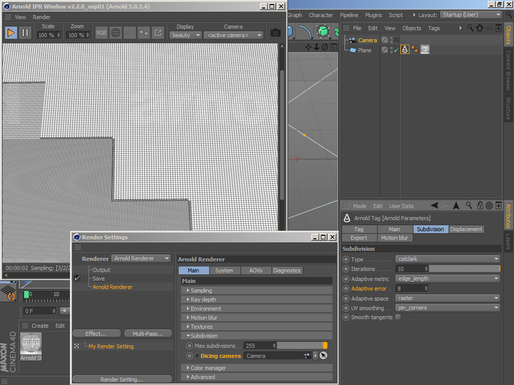

As well as this global subdivision control, you can also control the subdivision of an individual object via an Arnold tag, by setting Subdivision Iterations. The actual number of subdivisions for each object will be the lower of the two values.
Dicing Camera Example
An example scene file can be found here.
Camera set in Render Settings > Subdivision > Dicing camera. Subdivision > Adaptive error set in the Arnold tag on the object.
