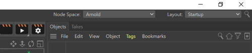

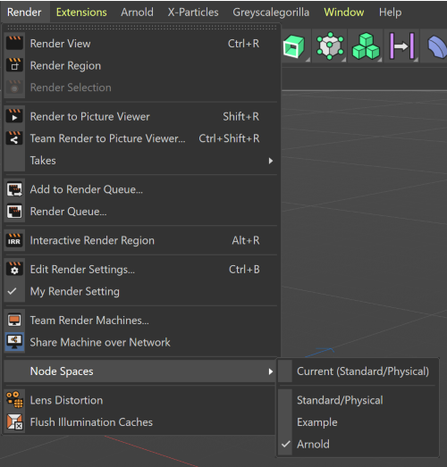

Before creating a new Node Material, make sure that the active Node Space is Arnold. If you select Arnold as the active renderer in the Render Settings, the Node Space is automatically set. Otherwise, you can set the Node Space on the application toolbar (Cinema 4D R24) or from the Render > Node Spaces menu.

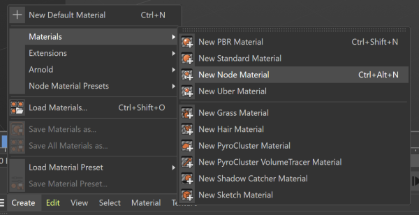

Node Space on the Cinema 4D R24 toolbar Node Space in the menu Create a Node Material from the Material Manager (Ctrl + Alt + N).
Double-click on the material to open the Node Editor.

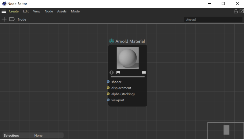

End Node
The shader graph must have an Arnold Material end node, which is added automatically when the material is created. The end node defines the surface and displacement subnetworks and other material-specific settings.

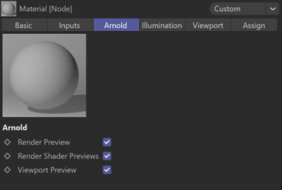

Material Settings
Render Preview
Render material preview (end node preview and Node Material preview in the Attribute Editor and Material Manager) when enabled. Otherwise, a default image (Arnold logo) is displayed.
Render Shader Previews
Render shader previews (Node Editor and Attribute Editor) when enabled. Otherwise, a default image (Arnold logo) is displayed.
Viewport Preview
Display a preview of the material in the viewport when enabled. Otherwise, display a default material with 0.8 base color.
Preview Scale
Scales the object in the preview scene from the default 1m size. For instance, setting the Preview Scale to 1cm (or 0.01), the object is scaled down to 1cm. This can be useful when working with small objects and previewing shaders that depend on length units (e.g., SSS radius, transmission depth, etc.).

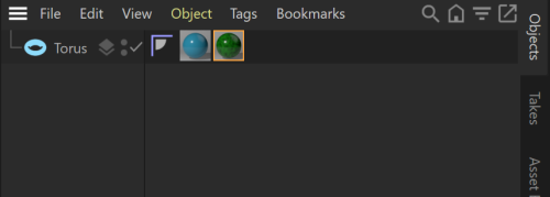

Material Stacking (alpha)
Shaders connected to the alpha input of the Arnold Material end node are used to drive the mix when the material is added on top of other materials (stacking).

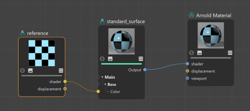

Reference Shader
The reference shader allows you to include another material, either a Node Material or an old Arnold Material, within the graph. For instance, you can create a procedural texture and reference it in multiple materials to drive different parameters. Modifying the referenced material will update all parent materials.
Info: Since an old Arnold Material can be referenced in the shader, it can be used to overcome the current limitations of the Node Material system.
Cycles are not permitted, which means you cannot reference material A in material B if material A already has a direct or indirect reference to material B.
