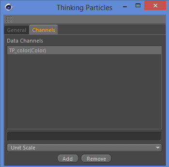

You can also define any custom TP channels. To see the available custom channels click on Simulate > Thinking Particles > Thinking Particles Settings... and select the Channels tab. Channel name must be set without the type, so if you have a channel listed TP_color(Color) you have to set TP_color to the export field.
