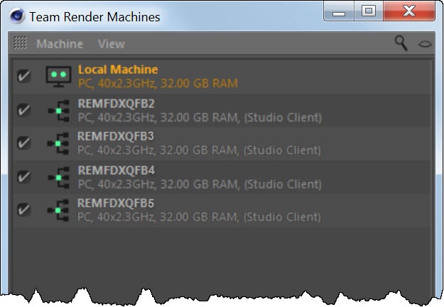

Every machine that renders with Arnold needs an Arnold license. For example, if this is your Team Render setup, you will need 5 Arnold licenses.

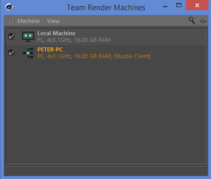

Setup client machines by opening the Render > Team Render Machines... dialog. Click Machine > Add Machine... and enter the IP address and port number of the client. You can check the address in the console of the Team Render Client (e.g. 192.168.1.120:5401). You must also enter the security token of the client which you can check in Machine > Preferences... of the Team Render Client dialog.

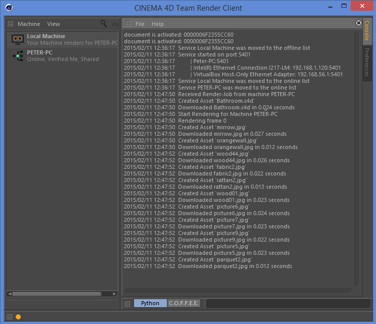

Start the render by clicking Render > Team Render to Picture Viewer... You should see messages in your Team Render Client console stating the download of the scene, any scene assets, and starting of the render.

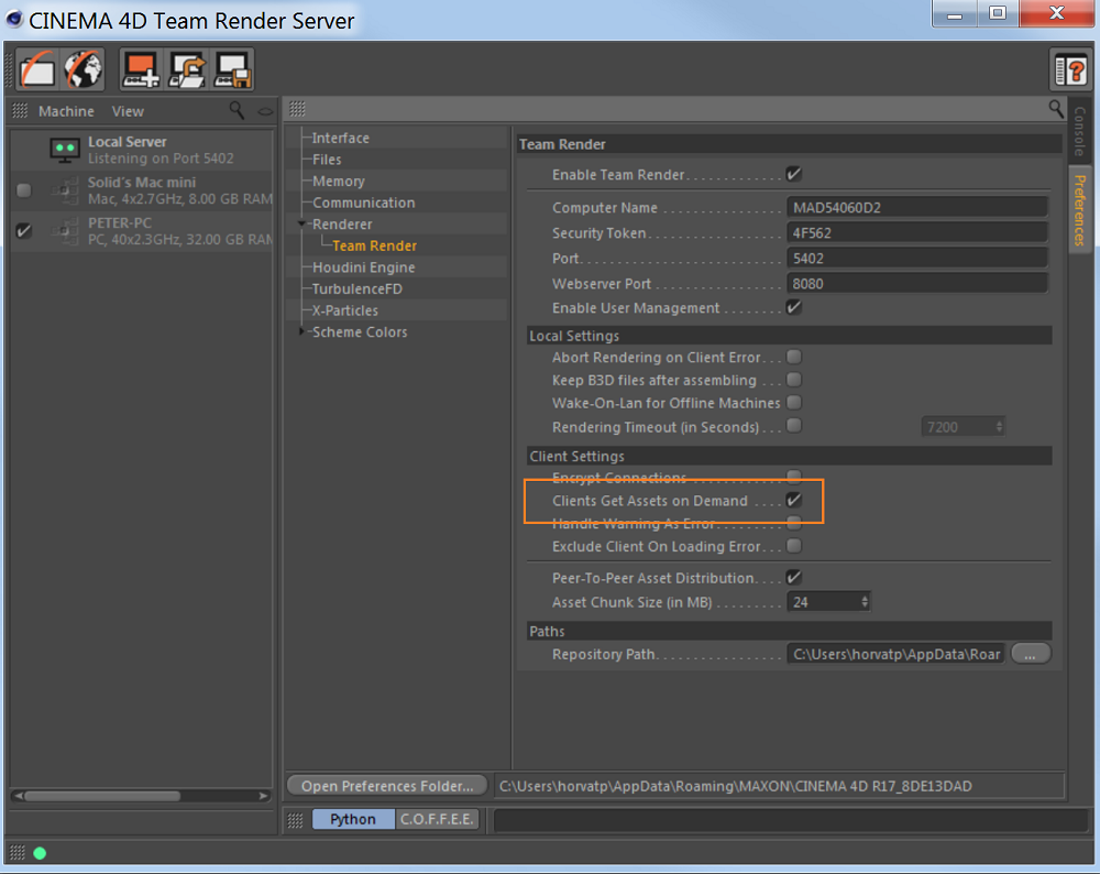

Info: Rendering via the Team Render Server loads the assets on demand. In cases when the assets are processed by Arnold (e.g. UDIM textures) you have to disable 'Clients Get Assets on Demand' in the Team Render settings of the server.

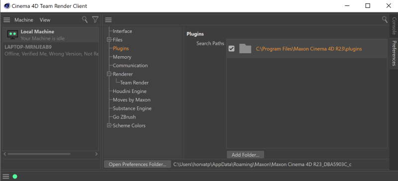

There's a known bug in Cinema 4D R23.008, that plugins are not loaded automatically in Team Render Client and Commandline render. The plugins folder (e.g. c:\Program Files\Maxon Cinema 4D R23\plugins) has to be added manually.
In Team Render Client go to File -> Preferences... -> Plugins -> Search Paths -> Add Folder...
