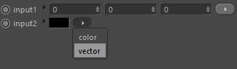

A collection of mathematical shaders. Math shaders can work on color or vector inputs.
Further Reading
See the Arnold User Guide for the list of available math shaders.
Note:
Because the Cinema 4D color picker is limited to the [0;1] range, these shaders have a custom widget where you can select between a color or a vector mode. In color mode, the color space transform is applied to the value. In vector mode, no color space transform is applied; the selected value is translated as it appears on the UI.
