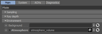

Atmosphere shaders are special volume shaders to simulate a light scattering effect in the scene, like fog. Atmosphere shaders have to be set in Arnold Render settings > Main > Environment > Atmosphere field.

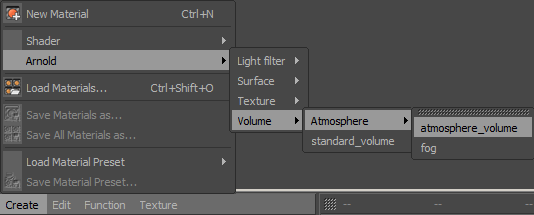

Atmophere shaders can be found can be found under Create > Arnold > Volume > Atmosphere in the Material Manager.
Once you have created the material, drag it onto the Atmosphere attribute in the Environment section of the Main Arnold Renderer settings.
