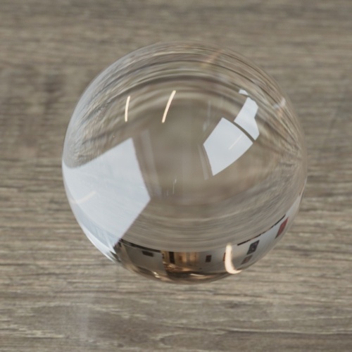

- Assign a Standard Surface shader to it. Change the following parameters to match that of glass:
Base Weight: 0
Specular Roughness: 0
Specular IOR: 1.52
Transmission Weight: 1
A glass preset is available in the presets menu in the attributes for the Standard Surface shader.

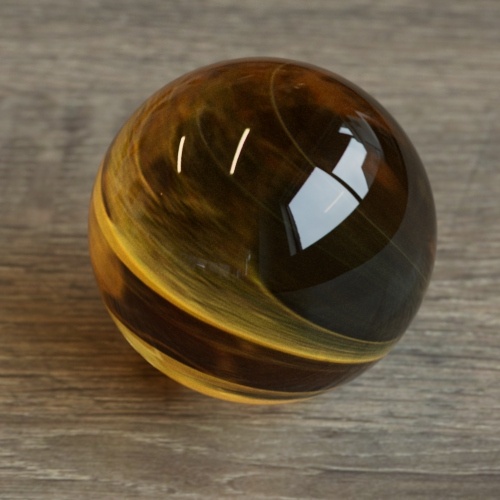

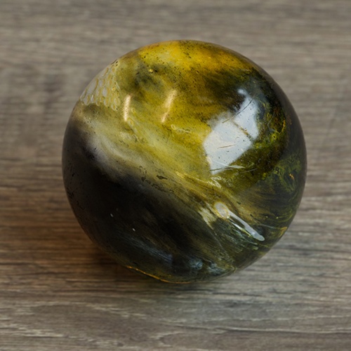

- Increase the Transmission Depth to 1. You may want to experiment with this value depending on the texture that you are using and the look that you want to go for. Changing this value will have a large effect on the overall marble shading, as you can see in the images below.
| Transmission Depth: 0 (default) | Transmission Depth: 1 | Transmission Depth: 3 |

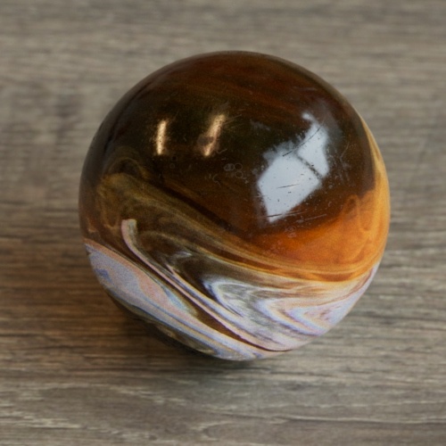

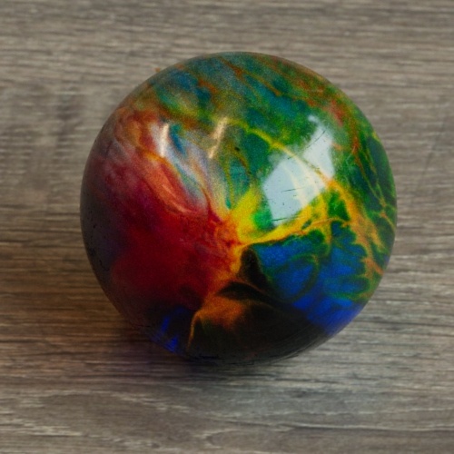

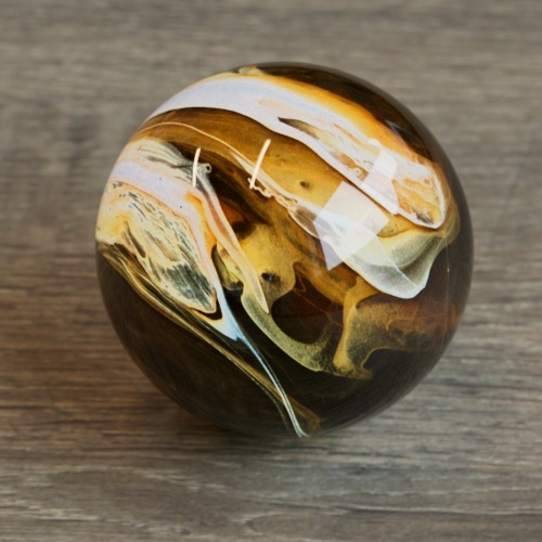

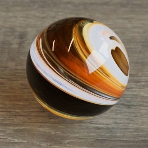

- Adjusting the U/V Angle (for spherical mapping only) of the UV Projection can give an interesting 'stretched' marble type pattern. You can also use the Matrix attributes of the UV Projection to further refine the effect.

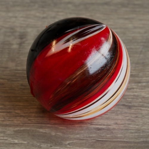

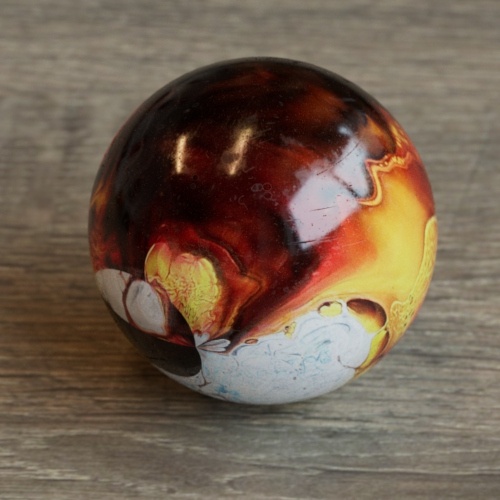

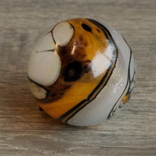

| u_angle: 30. v_angle: 230. scale_x: 0.3 | u_angle: 330. v_angle: 90. | u_angle: 270. v_angle: 30 |

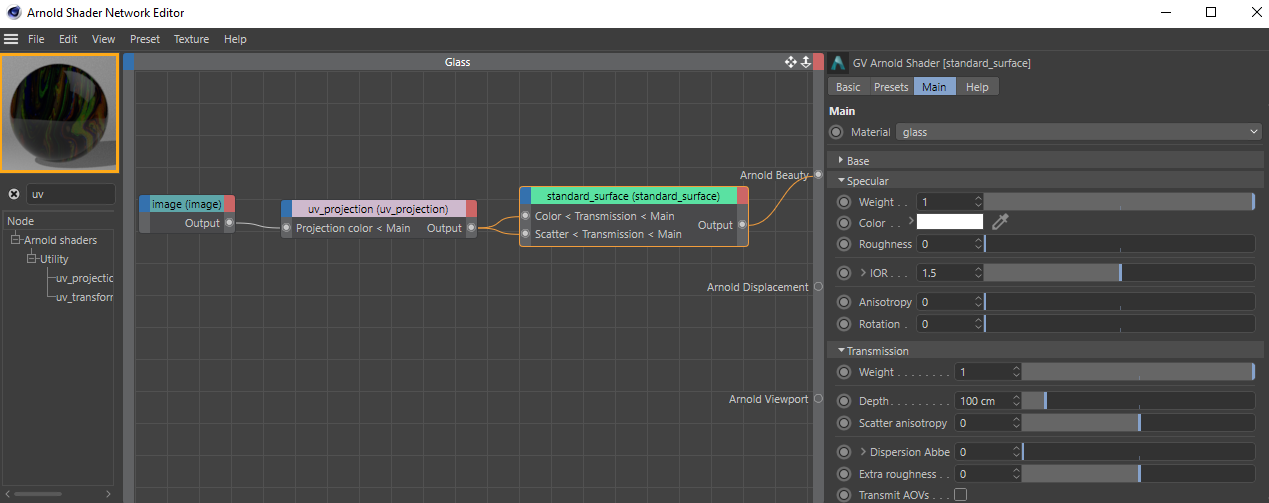

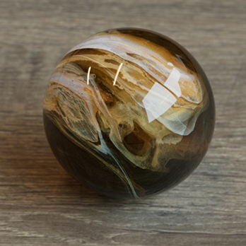

Final shading network for the glass marble

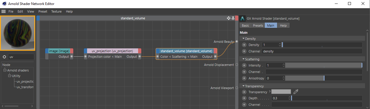

Now we want to add color to the volume using the same image (and projection) that we used for the glass shader.
- Connect the original UV Projection to the Scatter Color of the Standard Volume shader.
Image -> UV Projection -> Volume Scatter Color
- If the volume appears overly bright, try increasing the Transparent Weight and Transparent Depth of the Standard Volume shader. Adjusting these attributes can really help sell the effect of merging the glass with the volume underneath.
Final shading network for the volume

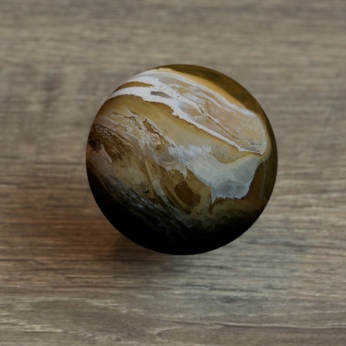

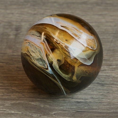

- Now unhide the glass sphere and render the scene.
Make sure that the Skydome Light has enough Volume Samples otherwise the volume will appear noisy.

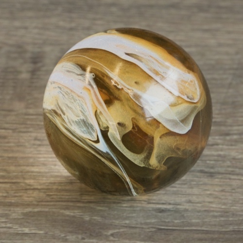

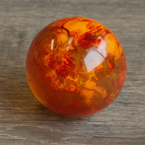

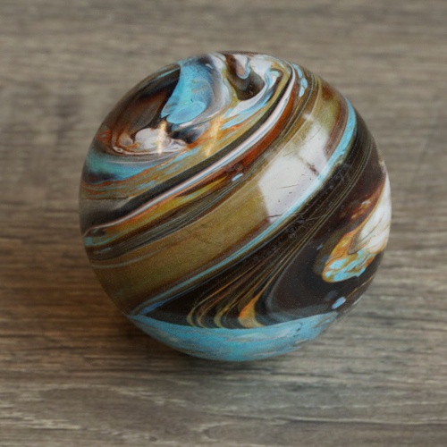

Marble glass shading with volume inside

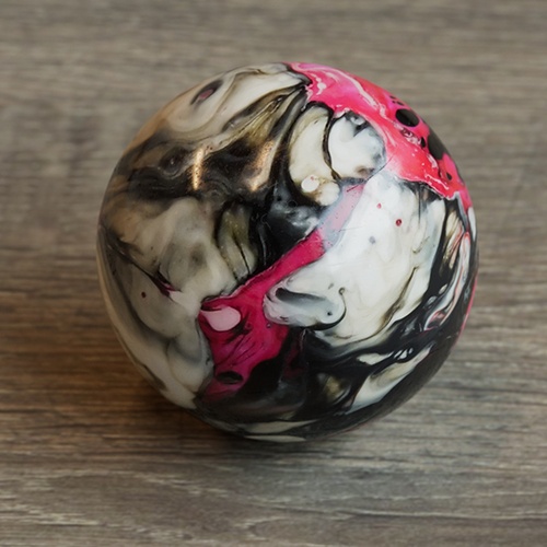

- Finally, try adding a scratch texture to the Specular Roughness of the glass shader (via a Range shader for extra control). This will help to break up the specular reflection and will add more realism to the final render. Alternatively, you could try using the scratch OSL shader (link below images). Be aware though that this shader can take a long time to render.
