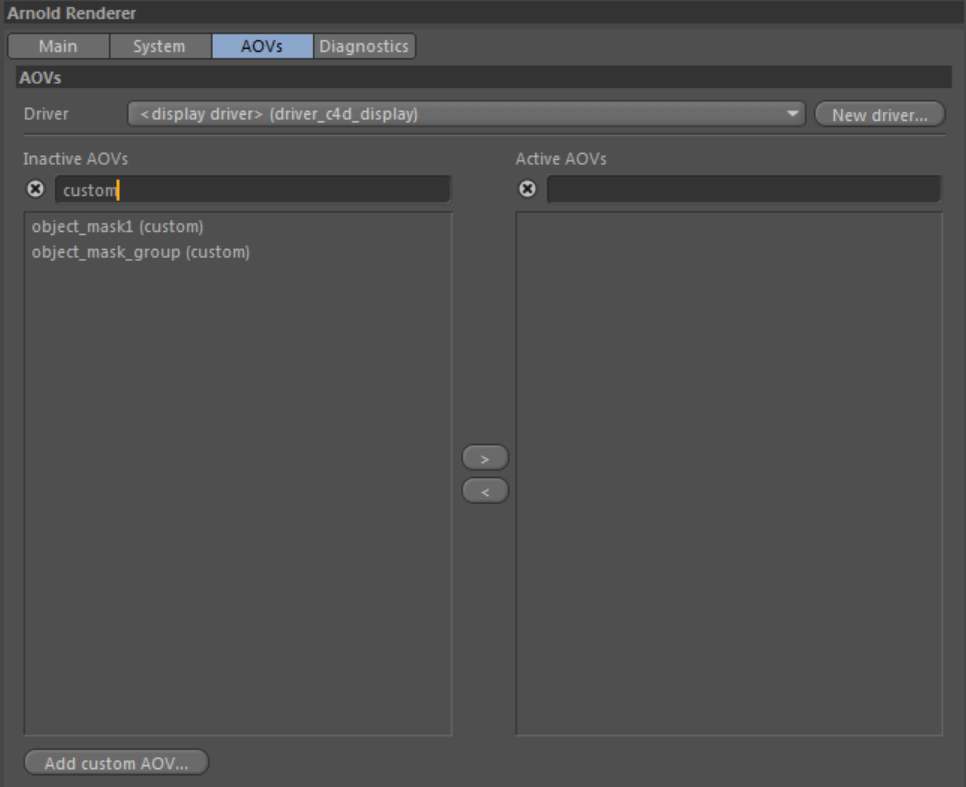

Now we have to activate the object mask AOVs.
- Go to the Arnold Render Settings and select the AOVs tab. All object mask AOVs have the (custom) postfix. Activate both AOVs by selecting them and clicking on the > button.
Once you click OK, a display driver is created in the Object Manager window containing the activated AOVs.
