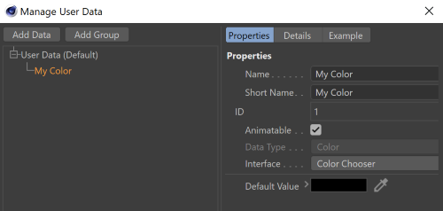

- Create a Color type user data in C4D and call it 'My Color':

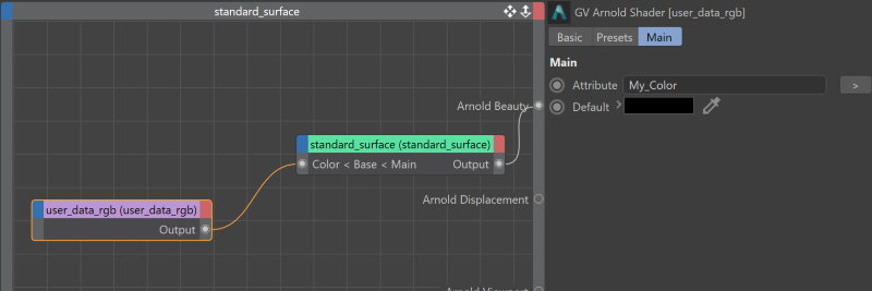

- Create an Arnold Material and read the 'My Color' user data via a User Data RGB shader.
Only alphanumerical characters, dashes (-) and underscores (_) are allowed in the parameter name. Arnold converts all other characters (including spaces) to underscores. For instance in the above example 'My Color' becomes 'My_Color', which you have to set in the User Data shader. Also note that parameter names are case sensitive.

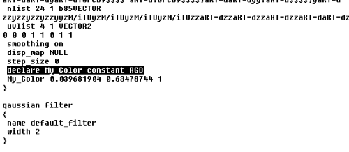

You can check the Arnold parameter name if you export the scene to an .ass file and look for the user parameter as follows:
