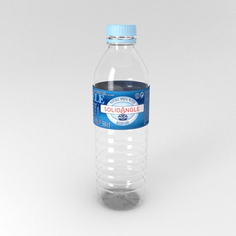

Shading the Bottle
The examples below show the effect of changing various attributes of the Standard Surface shader used for the plastic bottle shader.

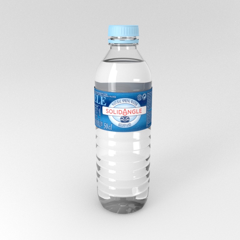

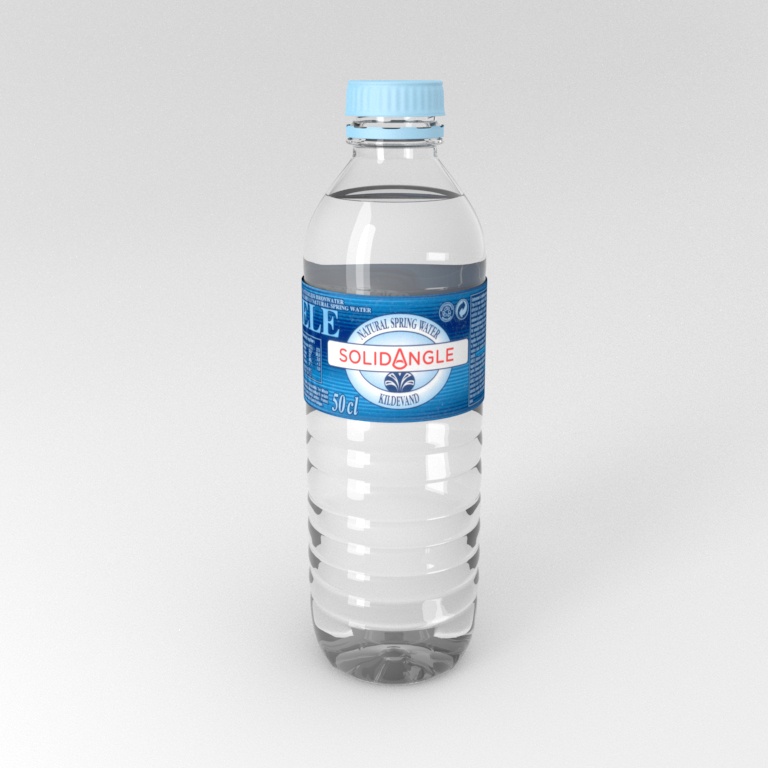

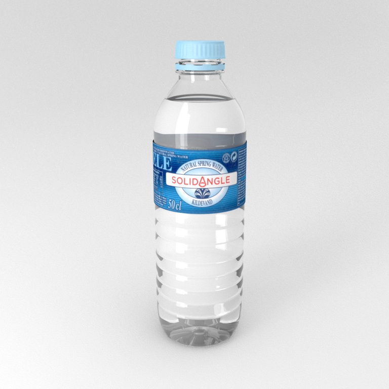

Enable Internal Reflections
Unchecking internal reflections will disable indirect specular and mirror perfect reflection computations in secondary bounces.
Bear in mind that even though disabling Enable Internal Reflections can dramatically reduce render times, it will also affect the appearance of the plastic. Therefore, you should ask whether accurate quality or speed is more important before using this feature.
| Enable Internal Reflections: On (17 mins 45 secs). | Enable Internal Reflections: Off (7 mins). |

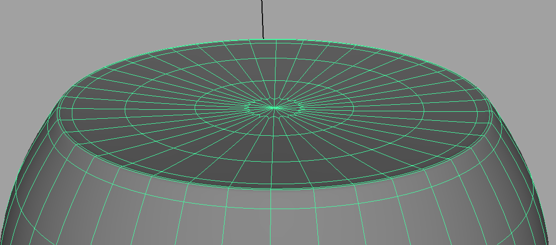

Liquid Meniscus
The top of the liquid has been modeled accurately with a meniscus. A meniscus is a curve in the upper surface of a liquid close to the surface of the container or another object, caused by surface tension.
Model the liquid meniscus. Ensure that you have enough edge loops to pull the top of the surface down.

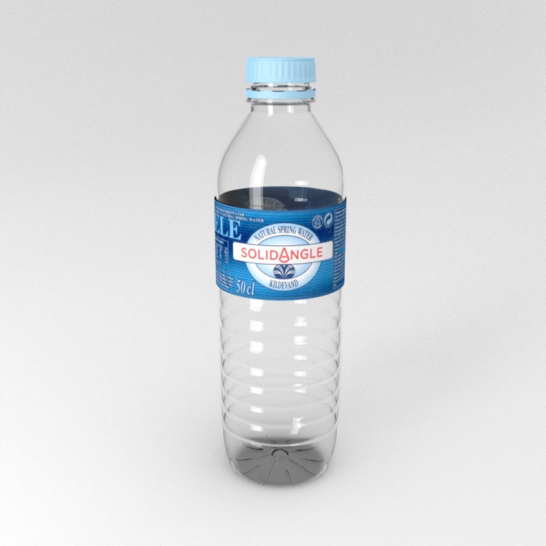

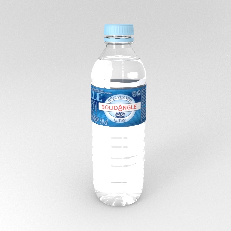

The examples below show the effect of changing various Standard Surface attributes for the water shader.

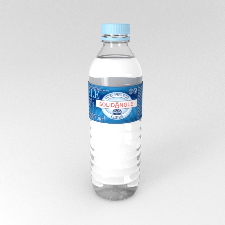

Base Weight
By default, the water looks a little dark. Adding a small amount of diffuse helps to 'lighten' the appearance of the water (note that this is not a physically accurate approach).
| Base Weight: 0 | Base Weight: 0.2 |

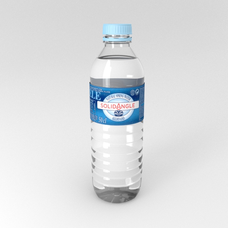

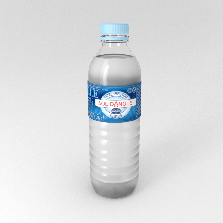

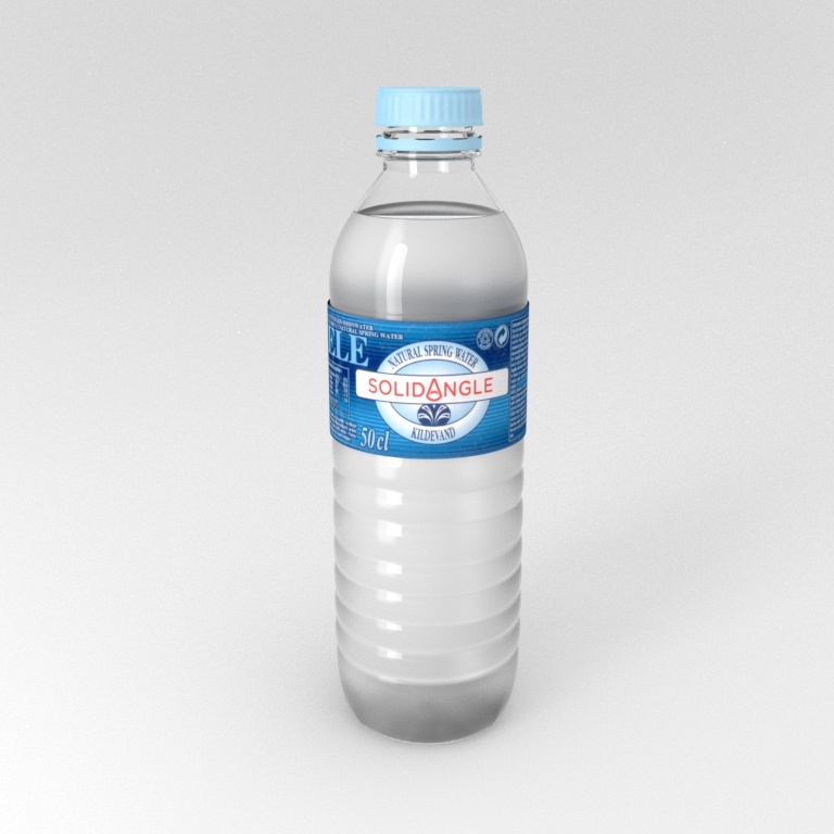

Cloudy Water
To make the water appear cloudy, the Transmission Roughness has been increased to 0.4. Increasing this value will add to the render times. A Ray Switch shader has been used to keep render times to a minimum.
Rayswitch
The Ray Switch shader can help to reduce the number of rays calculated in the scene, thereby improving render times without sacrificing quality.
The primary rays need to refract because of the cloudy roughness required to make the liquid look cloudy. Whereas the secondary glossy, shadow and diffuse rays are using a second shader (Water Secondary_Rays) that does not have specular/transmission roughness (this decreases render time).
As you can see in the images below, there is little difference in render quality and yet the render times have been reduced dramatically.
| No Rayswitch shader: 31 mins 15 secs | Rayswitch shader: 16 mins 14 secs |
