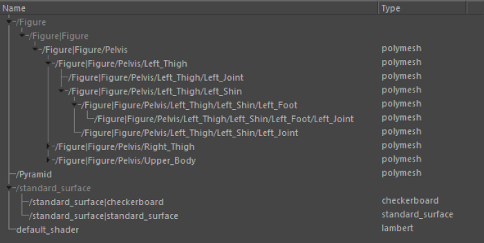

View Content
Opens a dialog that displays the content of the procedural as a node tree. You can copy the name of an object and paste it to the selection expression of the parameter overrides (see below).

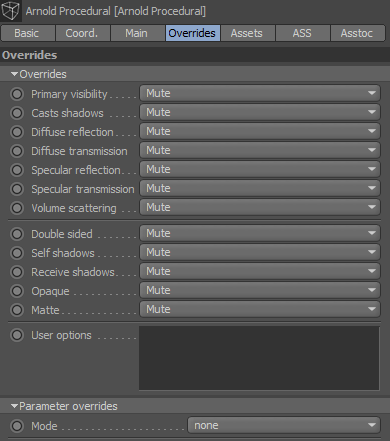

Shape Overrides
Choose to 'mute' or 'disable' various rendering options for selected Arnold Procedurals. This will override the values set within the procedural file. 'Mute' (set by default) uses the values set within the procedural file.

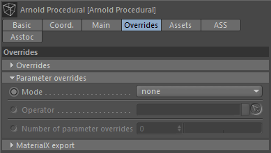

Parameter Overrides
These options allow you to override any parameters of the Arnold nodes (shapes, shaders, lights, etc.) created by the procedural object. See this tutorial for more details.
Mode
Specify the parameter override mode, selecting from the following:
  • none: No overrides.
  • operator network: Use an Arnold Operator network from the object tree.
  • parameter overrides: Specify overrides on the procedural UI.

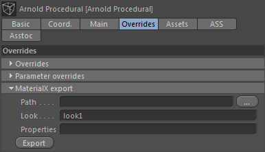

MaterialX Export
These options allow you to export the current overrides (look) to a MaterialX document (.mtlx). The export is always relative, so you can assign the look to another procedural with a different name.
Path
Choose the name and path that you want the .mtlx file to be saved as.
For existing mtlx files, the export will either update an existing look, or append a new look to the document.
Look
The look name to use in the exported MaterialX document.
Properties
Additional shape parameters to export. For example, step_size and volume_padding for a polymesh that is rendered as a volume.

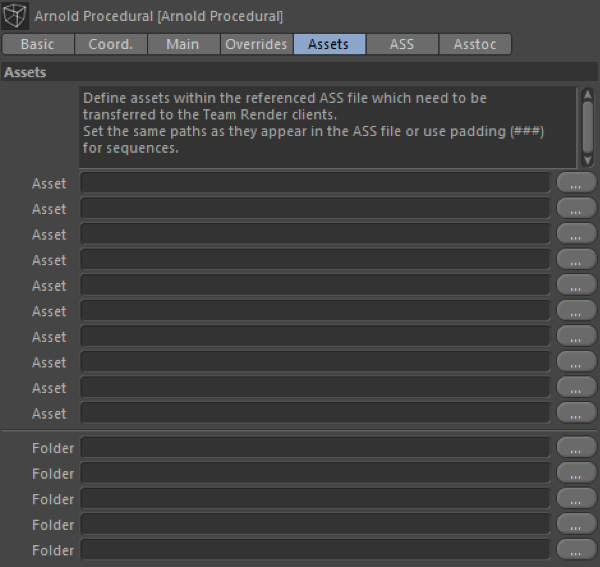

Assets
Procedurals can reference other assets in ASS files which are 'invisible' for C4DtoA. For example, if you have an object with a texture in your referenced ASS file, C4DtoA does not know anything about this texture and won't distribute it to the clients. In this case, you have to manually define these assets on the Assets tab.
It is important that you define the same paths here as they are in the ASS file. If the path is absolute in the ASS file, you must set an absolute path here. If only the file name is given, you must set the file name here as well. If you have a sequence in the ASS file, define it using padding () characters. This is because C4DtoA has to replace the path in the ASS file with the downloaded assets on the client machines. Note, that absolute paths do not work with ass.gz files.
You can also define folders in which case all files from the folders and subfolders will be transferred to the client machines. Note that this requires relative paths in the ASS file.
Info: Instead of defining assets here, you can keep your assets in a shared folder and add the folder to the Texture Search Path in the Render Settings.
