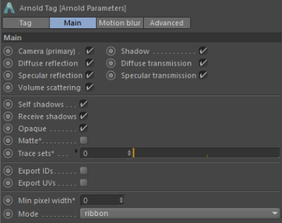

To add Arnold related parameters to the geometry you have to add an Arnold tag to it.
Main
Refer to the splines page to view more information about the specific hair attributes.
Export IDs
Hair IDs are exported to a curve_id user parameter. Curve index is used as the ID.
Export UVs
UV coordinates of curves are exported to uparamcoord and vparamcoord user parameters. More information and workflow examples can be found on the standard hair shader page.
Min Pixel Width
If this value is non-zero, curves with a small on-screen width will be automatically enlarged so that they are at least the specified size in pixels. The enlargement fraction is then used in the hair shader to adjust the opacity so that the visible thickness of the hair remains the same. For a given number of AA samples, this makes it a lot easier to anti-alias fine hair, at the expense of render time (because of the additional transparency/depth complexity). Good values are in the range 0.2 to 0.7. Values closer to 0 are faster to render but need more AA samples. So if your scene already uses very high AA settings, you should use a low value like 0.1. For best results, you may need to increase the auto-transparency depth and/or lower the auto-transparency threshold, but watch the effect on render times. Note that this parameter currently works with the ribbon mode only, and Opaque must be disabled.
Min Pixel Width: 0.1 Min Pixel Width: 1
Mode
There are two algorithms for rendering curves in Arnold: ribbon and thick.
ribbon_mode thick_mode

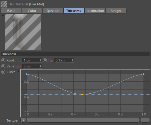

Thickness
Hair thickness can be defined using the Thickness tab of the native Hair Material. You can set up root/tip width, a random variation, and scaling thickness along a curve (e.g., make hair thinner in the middle, etc.).
Note:
Textures are not supported to control thickness.
