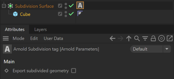

However, in some cases, Arnold's subdivision does not match the result in Cinema 4D. For example, if deformers are used under the Subdivision Surface object. In these situations you can export the final subdivided geometry from Cinema 4D instead, by adding an Arnold tag to the Subdivision Surface object (C4DtoA Tags > Arnold Parameters) and enable Export subdivided geometry.
