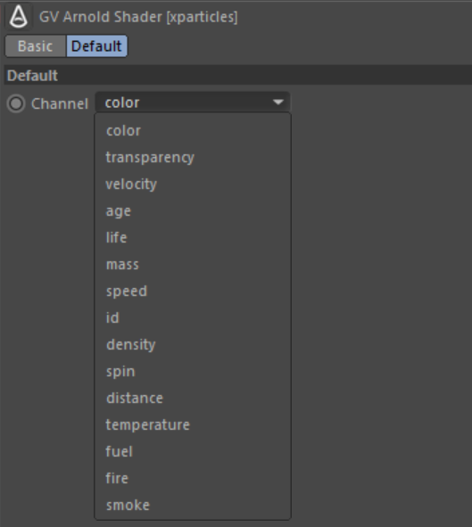

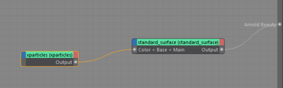

The X-Particles shader reads the exported channels of an X-Particles Emitter (including the color of an X-Particles Material). If no shader is assigned to an X-Particles Emitter, then the default color channel is rendered. You can also use this shader together with any other surface shader (such as connected to the base_color channel of a standard_surface shader).
