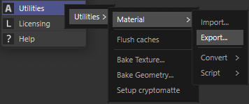

You can export the selected Arnold Materials to ASS or MaterialX files via the Utilities > Material > Export... menu or the Alt+W~X shortcut from the Material Manager, allowing you to create DCC-independent material libraries, transfer materials to other users, and exchange materials or shader networks between DCCs. You can also export MaterialX looks (shader assignments) via this dialog for look development.

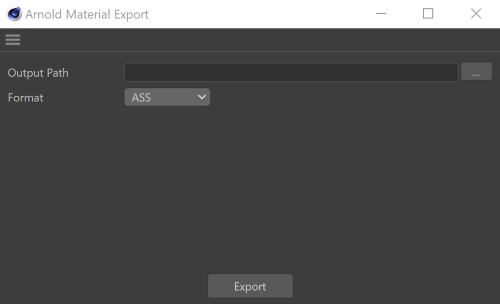

Export Arnold Materials
Output Path
Choose the path that you want the ASS or MaterialX file to be saved as.
Format
Choose between ASS (.ass) or MaterialX (.mtlx) output.
Info: Shaders can be exported directly from the Arnold Shader Network Editor as well.

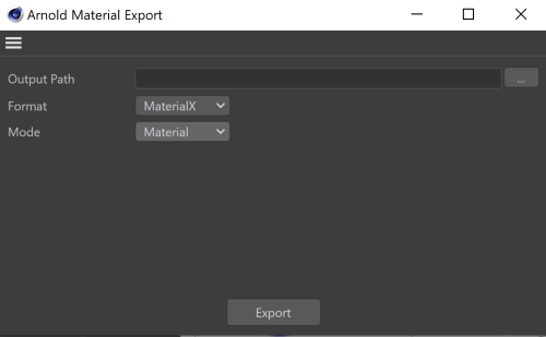

Export MaterialX look

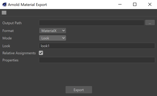

Output Path
Choose the name and path that you want the .mtlx file to be saved as.
For existing mtlx files, the export will either update an existing look or append a new look to the document.
Look
The look name to use in the exported MaterialX document.
Relative Assignments
If set, the shader/property/visibility assignments will be relative to the namespace the shape is in; otherwise, the assignments will contain the full path to the shape. For instance, if a sphere named sphere1 resides in a procedural my_proc, the full name would be my_proc/sphere1 and the relative name sphere1. This makes it possible to assign the look to another procedural with a different name.
Properties
Additional shape parameters to export. For example, step_size and volume_padding for a polymesh that is rendered as a volume.
The following shape parameters are automatically exported (if they are set to non-default values):
  • visibility
  • sidedness
  • disp_padding
  • disp_height
  • disp_zero_value
  • disp_autobump
  • autobump_visibility
