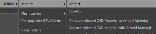

You can import shader networks from ASS or MaterialX files to Arnold Materials via the Utilities > Material > Import... menu or the Alt+W~I shortcut from the Material Manager.
