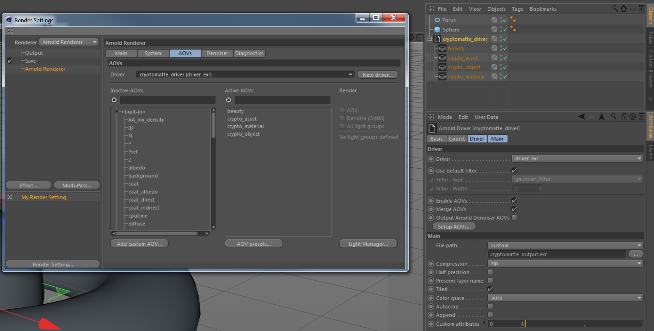

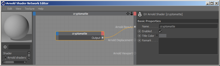

The Setup cryptomatte command in the Arnold > Utilities menu adds all necessary shaders, drivers, and AOVs to the scene:
  • Creates a cryptomatte shader and assigns it to the AOV shader list in the Arnold Render Settings.
  • Creates an EXR driver with the three cryptomatte AOVs (see above) and Merge AOVs turned on. You just have to specify the path of the EXR output in the driver.
Info: The Setup cryptomatte command is also available as a python script.
