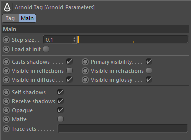

Any TurbulenceFD Container object in the scene will render as an Arnold volume. To define parameters for the volume, you must add an Arnold tag to the container.
Step Size
Defines the sampling quality. Lower values collect more volume samples, resulting in higher detail and sharper volume features at the cost of longer render times.
Note:
Note that quality also depends on the TFD voxel size and simulation settings. After a certain step size, the quality will not change. However, the render time will increase.

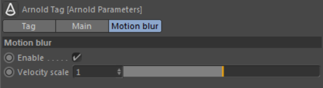

Motion Blur
The Motion blur tab offers a setting to enable/disable motion blur by TFD containers individually. Note that you still have to enable motion blur in the Render Settings first. You have to simulate the volume with the velocity channel enabled.
Velocity Scale
Defines the strength of the motion blur effect. It's basically a multiplier of the velocity vector.

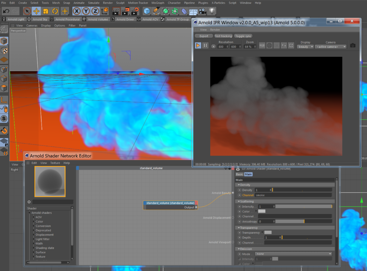

Turbulence FD workflow

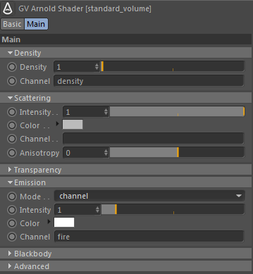

A TFD container exports as a volume; therefore, you can use any volume shader to shade it. The default is a standard_volume shader which uses density as the scattering and fire as the emission channel.
The following channels are exported from TFD (if they are enabled in the simulation):
  • density (float)
  • velocity (vector)
  • temperature (float)
  • burn (float)
  • fuel (float)
  • solid (float)
  • smoke (RGB)
  • fire (RGB)
Info: To render the output of the smoke shader, you must use the smoke channel as scattering instead of density.
Density channel set to 'smoke'
A tutorial on rendering Turbulence FD volume with Arnold can be found here.

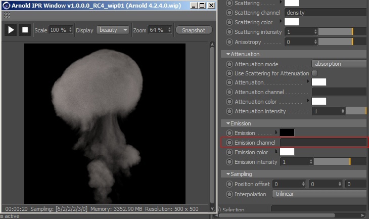

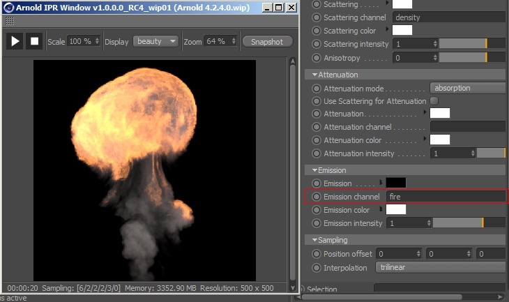

Example
without 'fire' emission with 'fire' emission

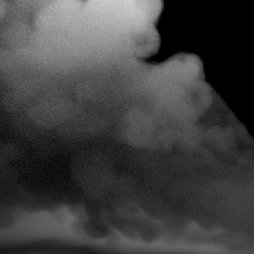

Reducing Noise
To reduce the amount of noise in a TFD container, you must ensure that any lights in your scene have sufficient volume samples. Alternatively, increase the AA samples.
