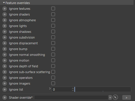

This group of switches allows you to disable a number of important rendering features. By selectively disabling some features, you can get a feel for where the renderer is spending most of the time, which helps optimizing scenes. Lighting or look-dev could be sped up by enabling Ignore Textures or Ignore Shaders for example. This is also useful for isolating errors and artifacts when debugging. Note that not all of these options are interactive - some of them may require the entire scene to be refreshed/exported.
