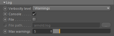

Verbosity Level
Specifies the amount of information in the log messages, with Warnings being least and Debug most:
  • Errors: Show errors only.
  • Warnings (default): Show error and warning messages.
  • Info: Show errors, warnings, statistics, and any info that does not slow down rendering.
  • Debug: Show all information. Take care when using this mode as render times may increase.
Console
Shows the log in the Cinema 4D Console (in the Standard layout, click Extensions > Console to see the log).
File
If enabled a log is written to the specified file.
File path
Specifies the output path for Arnold log files. You can use environment variables. You can use padding (#) in the file name.
Max Warnings
Limits the number of warning messages (of a similar type) that are sent to the log.
