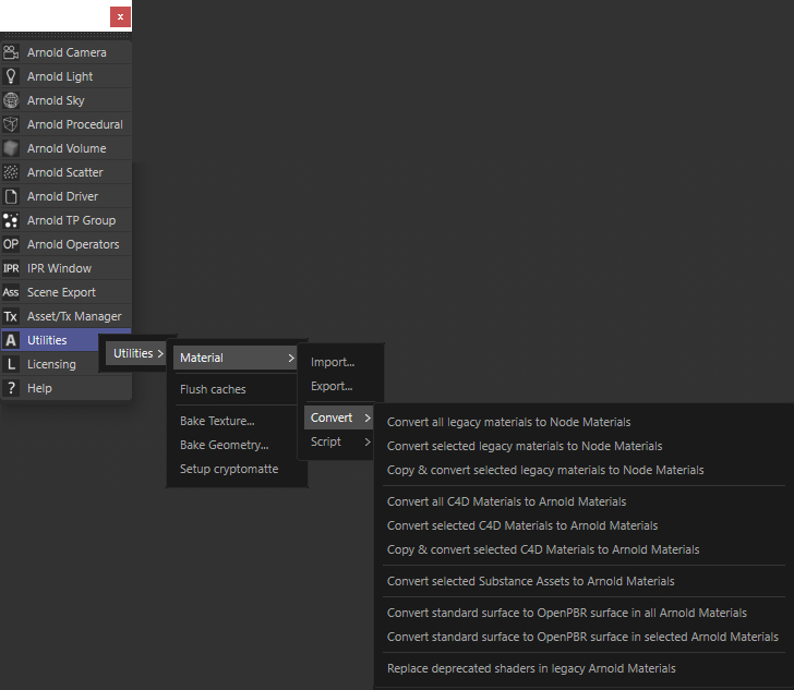

The Arnold > Utilities > Materials > Convert menu contains commands to convert between the supported material types and convert specific Arnold shaders.
Legacy Arnold Material to Node Material
Convert all legacy materials to Node Materials
All legacy Arnold Materials in the current scene are replaced with Arnold Node Materials.
Convert selected legacy materials to Node Materials
The selected legacy Arnold Materials in the current scene are replaced with Arnold Node Materials.
Default shortcut is Alt+W~D in the Material Browser.
Copy & convert selected legacy materials to Node Materials
The selected legacy Arnold Materials are converted to Arnold Node Materials, the legacy materials are kept in the scene.
Default shortcut is Alt+W~C in the Material Browser.
Cinema 4D Standard Material to Arnold Material
Convert all C4D Materials to Arnold Materials
All Cinema 4D Standard Materials in the current scene are replaced with Arnold Materials.
Convert selected C4D Materials to Arnold Materials
The selected Cinema 4D Standard Materials in the current scene are replaced with Arnold Materials.
Copy & convert selected C4D Materials to Arnold Materials
The selected Cinema 4D Standard Materials are converted to Arnold Materials, the Cinema 4D Standard Materials are kept in the scene.
Info: The type of the Arnold Material (Node Material vs legacy material) depends on the default material system set in the Preferences.
The resulting Arnold Material won't be a perfect match to the Cinema 4D Material since Arnold has different shaders and concepts. See the Cinema 4D Material page for the supported features and limitations.
Substance Asset
Convert selected Substance Assets to Arnold Materials
Converts all selected Substance Assets to an Arnold Material. A Substance Shader is created for each texture of the asset and connected to the appropriate parameter of a root standard surface shader.

OpenPBR Shader
Convert standard surface to OpenPBR surface in all Arnold Materials
Standard surface shaders in all Arnold Materials are replaced with OpenPBR surface shaders.
Convert standard surface to OpenPBR surface in selected Arnold Materials
Standard surface shaders in selected Arnold Materials are replaced with OpenPBR surface shaders.
Deprecated Shaders
Replace deprecated shaders in legacy Arnold Material
The hair, standard, and volume_collector shaders are deprecated in Arnold 5, they will be removed in a future release. Use this command to convert these shaders to their replacements (standard_hair, standard_surface, and standard_volume). The shaders can be converted individually as well.
