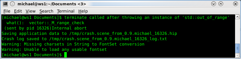

> $ terminate called after throwing an instance of 'std::out_of_range'
It is possible to fix these scenes to allow them to be opened. Note that any connections to altered parameters will not be relinked.

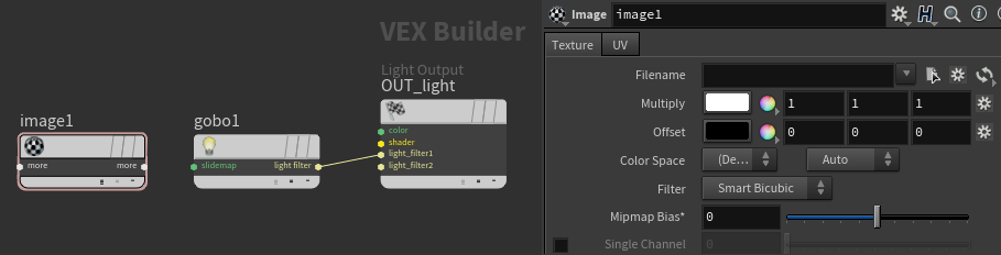

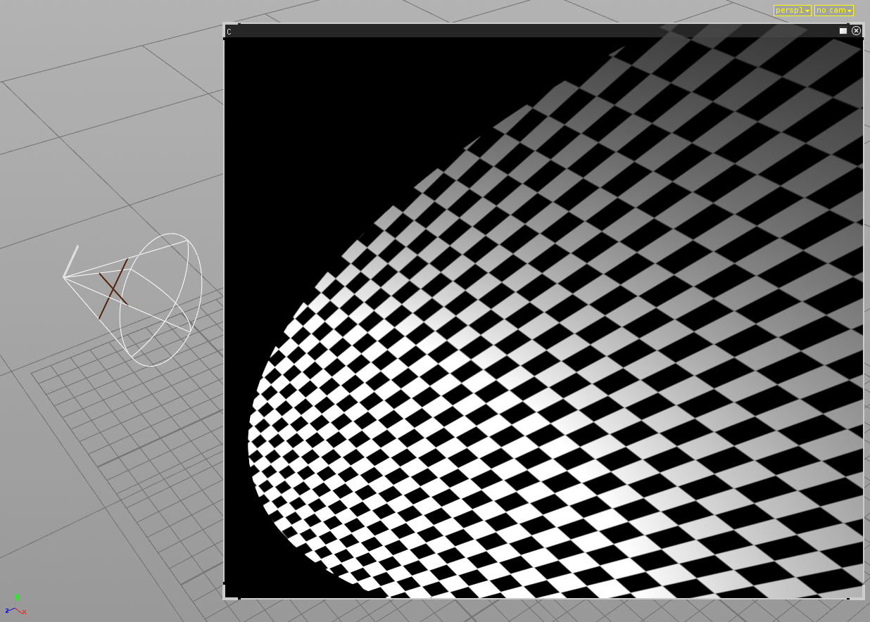

Here is a scene created with 0.9.2, which has a texture assigned to the Density parameter of a Spotlight's Gobo.
All the available parameters are visible on the gobo1 node.
Linkability to Gobo parameters was removed in Arnold 4.1.1 which is what HtoA 0.10.0 uses so the above scene crashes when opened in that version.

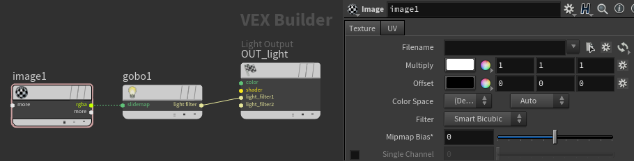

Now the scene should be able to be opened with any fixes applied. In this case, we can see that the Gobo's parameters have been updated and the image node has been disconnected.
