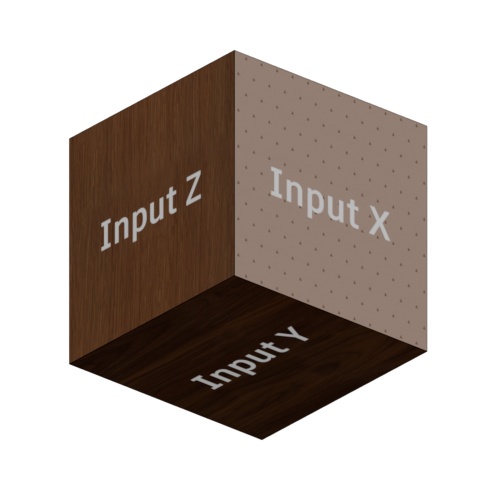

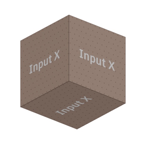

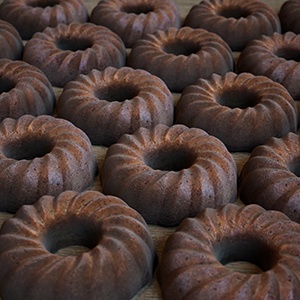

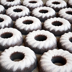

  • Per axis texture in triplanar: The triplanar shader can now optionally use different textures for each axis. ARNOLD-11708.
input_per_axis: disabled (default) input_per_axis: enabled

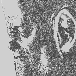

A wide range of shading effects such as snow, dust, sand, and moss, can be achieved using input_per_axis (Y).
Rollover images to view with and without triplanar.input_per_axis (Y)
A video that shows how to use the input_per_axis can be found here.

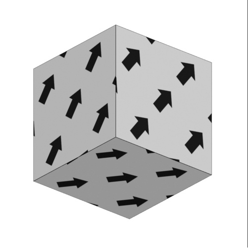

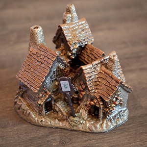

  • Flip_on_opposite_direction in triplanar: A new parameter called flip_on_opposite_direction can also be used to control the behavior of the shader on faces facing the corresponding negative axis. ARNOLD-11615.
flip_on_opposite_direction: enabled (default) flip_on_opposite_direction: disabled

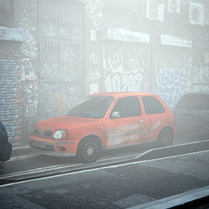

  • Better startup and update times with atmosphere shader: Starting renders and updating parameters when using a high number of AA samples with a volume_scatter atmosphere shader should now be much faster. ARNOLD-5503
    Render times of a simple scene with volume_scatter.samples=30:
| AA | AA_max | Arnold 7.0 | Arnold 7.1 |
| 4 | 50 | 5:28min (node update: 5:20min) | 8 sec (node update: 0 sec) |

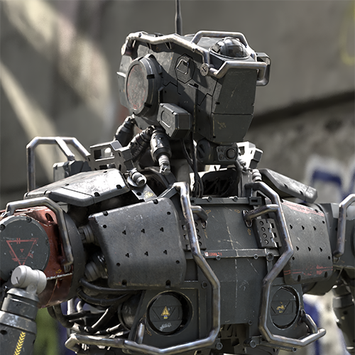

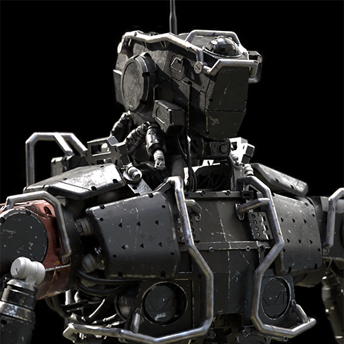

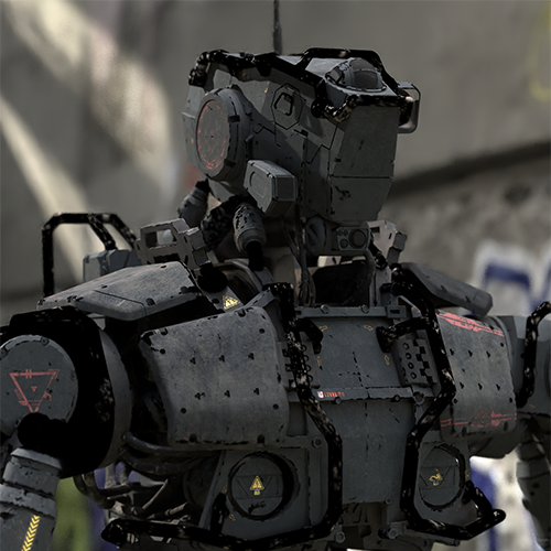

  • AOV denoising with the OptiX denoiser: Upgraded from the Optix 6 to Optix 7 denoiser. This newer denoiser supports denoising AOVs in a way that allows the denoised result to be compositable. Prevoius OptiX denoisers had no guarantees that the denoised results would combine correctly. ARNOLD-11726
    Original beauty Denoised beauty Denoised diffuse AOV Denoised specular AOV Denoised diffuse + denoised specular
