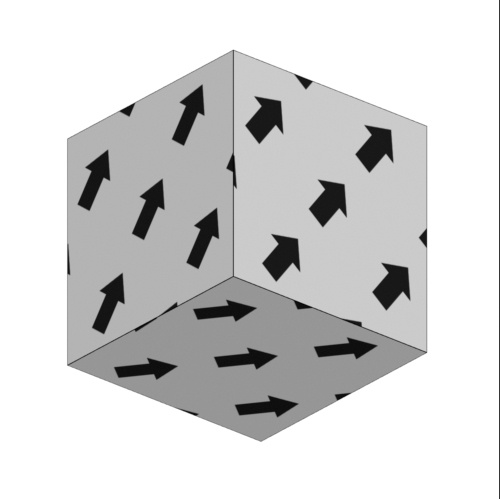

  • Per axis texture in triplanar: The triplanar shader can now optionally use different textures for each axis. ARNOLD-11708.
input_per_axis: disabled (default) input_per_axis: enabled

  • Flip_on_opposite_direction in triplanar: A new parameter called flip_on_opposite_direction can also be used to control the behavior of the shader on faces facing the corresponding negative axis. ARNOLD-11615.
flip_on_opposite_direction: enabled (default) flip_on_opposite_direction: disabled
