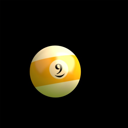

Before we render the Motion Vector AOV, we must first separate the pool ball from the background. We will render the pool ball (with the Motion Vector AOV) separately and composite them together in a post-processing program like Nuke.
  • Before rendering the pool ball separately, we must enable Instantaneous Shutter in the Motion Blur settings. The reason is that we don't want motion blur in the render, but we still want the motion velocity information in the motion vector AOV.
  • Select the geometry in the scene (except the pool ball that we want to motion blur) and disable their Primary Visibility). You should just see the pool ball rendered on its own.
Pool ball render (Primary Visibility disabled for the rest of the scene)

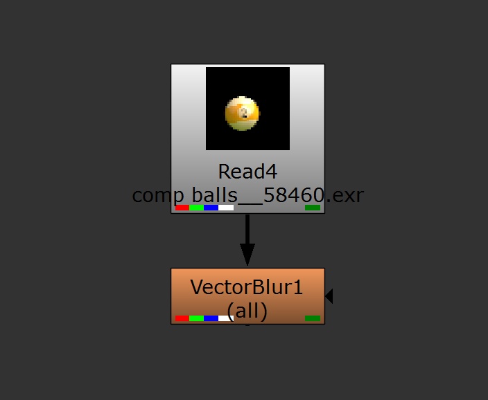

  • Connect a 'Vector Blur' node to the pool ball render. We will use the Vector Blur node to blur the pool ball using the 'Motion Vector AOV'.

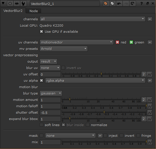

  • Select the VectorBlur node. Change the uv channels to motionvector, and the mv presets to Arnold. Enable uv alpha and choose rgba.alpha to prevent the blur from being clipped by the alpha of the motionvector AOV.
Vector Blur node settings in Nuke
VectorBlur alpha disabled: incorrect VectorBlur: alpha enabled: correct

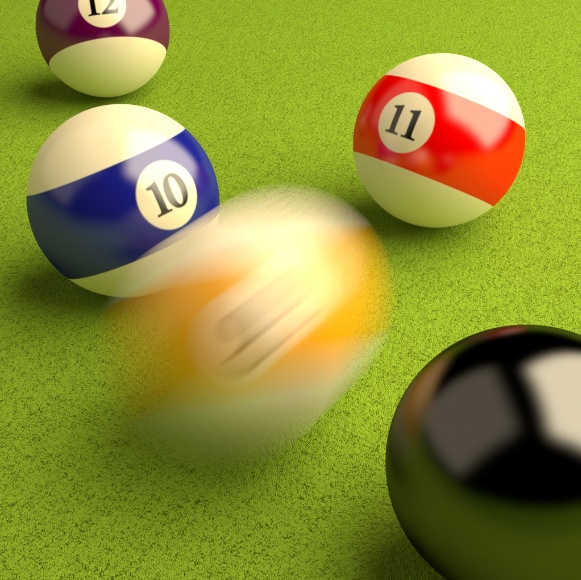

Finally, we should see the pool ball render composited onto the background render as follows:
Pool ball rendered with Motion Vector AOV Background render Pool ball composited onto background

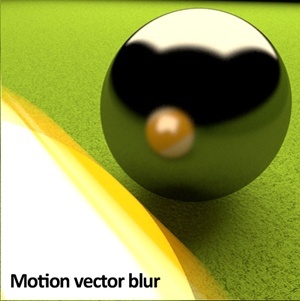

There are some limitations when rendering a 2D motion vector compared to rendering Arnold's native 3D motion blur. Some of these limitations include motion blur in a reflective surface, deformation blur, no true 3D motion blur effects, such as a wheel spinning that is not facing the camera, and time-lapse effects using motion-blurred light sources.
Reflected motion blur is not possible when using Motion Vector blur
