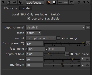

  • Connect a 'Zblur' ('ZDefocus' in Nuke 7) to the EXR render and enable 'focal-plane setup'. The default setting of the Zblur node should work. Z should be set to 'depth.z' and 'math' should be set to 'depth' (the Z value in the depth channel is the distance in front of the camera).
  • Adjust the 'focus plane' until the green area is where you want the area of focus to be. The red color shows the area that has less depth of field. The blue color represents the area that falls outside the depth of field area. The green color represents the area that is inside the area of depth of field. If the depth parameter is set to 0, you will not be able to see any green.
Focal-plane setup enabled (green area is in focus)
  • Once you are happy with the 'focus plane', disable 'focal-plane setup'. Increase the 'depth-of-field' to one. You should now see the RGB image being blurred by the 'Zblur' node.
