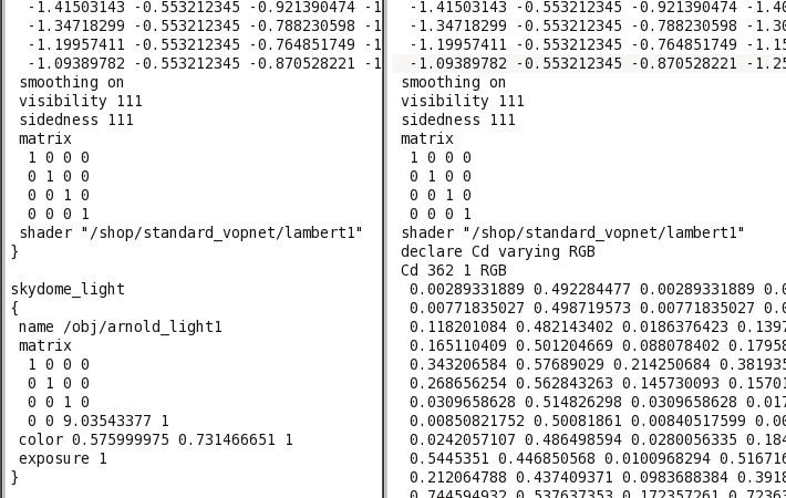

In order to use attributes, they must be exported to the .ass file by naming them specifically in the Arnold geometry properties. Available attributes will be listed on the drop-down arrows on the right.
Using the Cd example from the User Data page, the sphere will not have any color until the Cd attribute is passed to the .ass file.
default .ass file (left) and with Cd exported via the Attributes tab (right).
