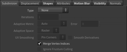

These settings are provided for geometry objects.
Note:

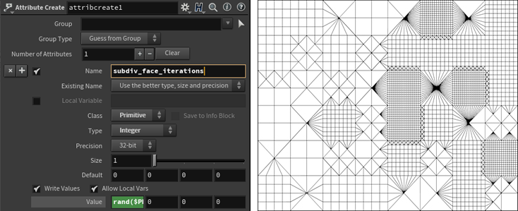

Currently, for Catmull-Clark to work on a Polygon Mesh "Unique Points Per Pole" needs to be enabled at the object geometry level.
Example showing random values of subdiv_face_iterations in the [0-4] range on the faces of a grid
