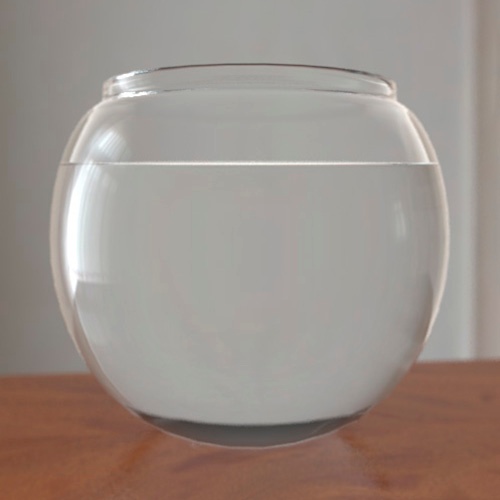

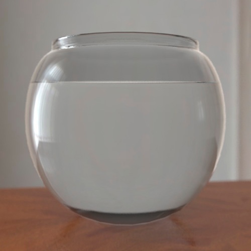

Lowering the Transmission Weight value attenuates the amount of light that passes through the volume of the glass (distance-based coloring). By default, Transmission Color is white, which means no distance-based tint. Try lowering it from full white.
Transmission Color: Gray Transmission Color: White

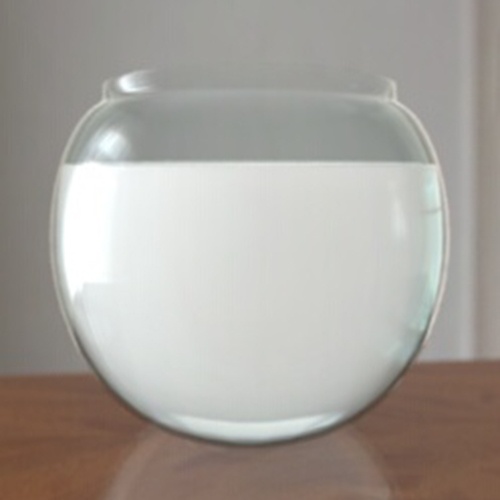

Standard Surface - Milky liquid
To create a milky liquid, it helps to add small amounts of sub-surface scattering. Additionally, to make the liquid appear more vibrant, you could experiment by adding a small amount of Emission Weight to it.
SSS Weight: 0.1 SSS Weight: 0.1. Emission: 0.1
