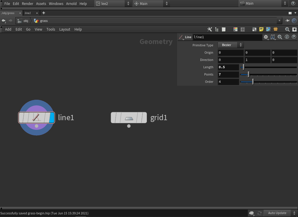

Next, we will create a single blade of grass.
  • Create another default grid and rename it 'grass'.
  • Enter the grid geo level.
  • Create a Line and set it to be visible by clicking the blue right square of the node.
  • Change the Primitive Type to Bezier.
  • Change the Length to 0.5.
  • Change the Points to 7.

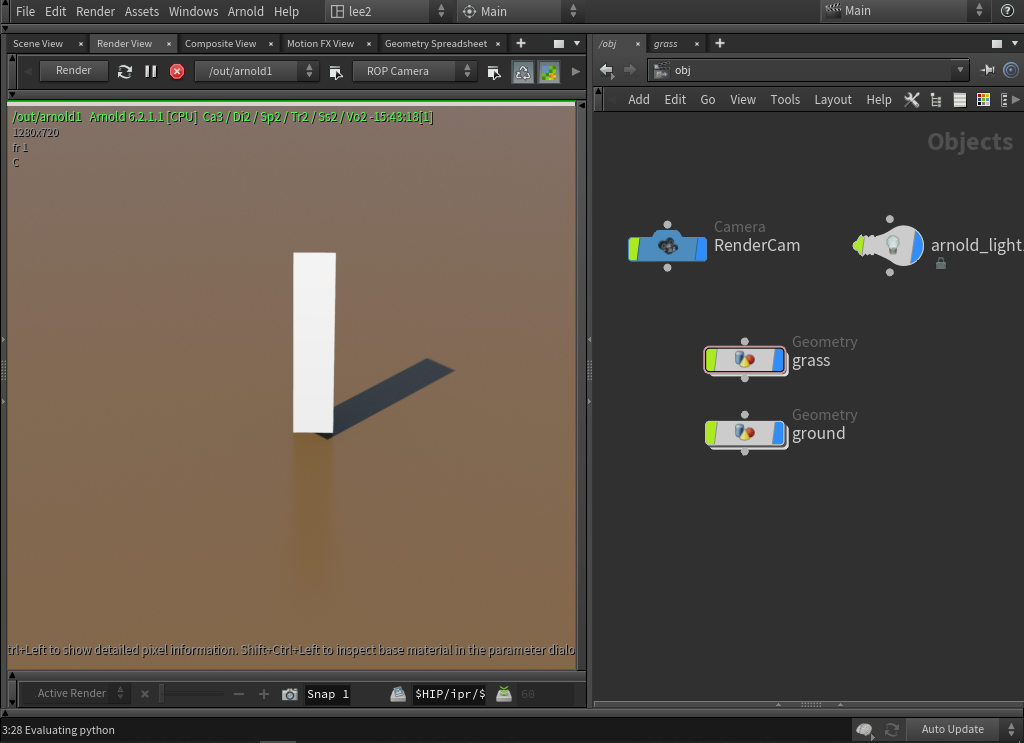

  • Zoom into the curve and render the grass.

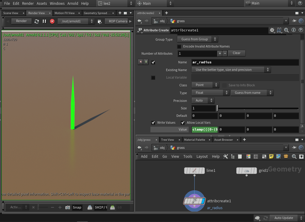

Now we need to override the radius of the curve to taper the grass. To control the radius of the curve and shape the grass, we need to create an Attribute.
  • Go to the grass object level and attach an Attribute Create node to the line.
  • Change the name of the attribute to ar_radius.
  • We are going to be using the inbuilt variable $PT, which is the Point Number along the curve. However, it needs to be modified by an expression to taper the top into a rough grass shape. See below for the process of arriving at the expression.
  • The final expression is: clamp(((0-($PT-5))/100),0,0.015)

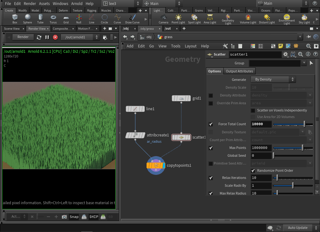

Now we need to make the patch of grass.
  • Create another grid (Toolbar > Grid).
  • Create a Scatter node.
  • Increase the Force Total Count of the Scatter node to around 10,000. This will give us many more points to copy the grass across.
  • Connect the grid to the Scatter node.
  • Create a Copy to Points node and connect the attribcreate and Scatter nodes to it.
