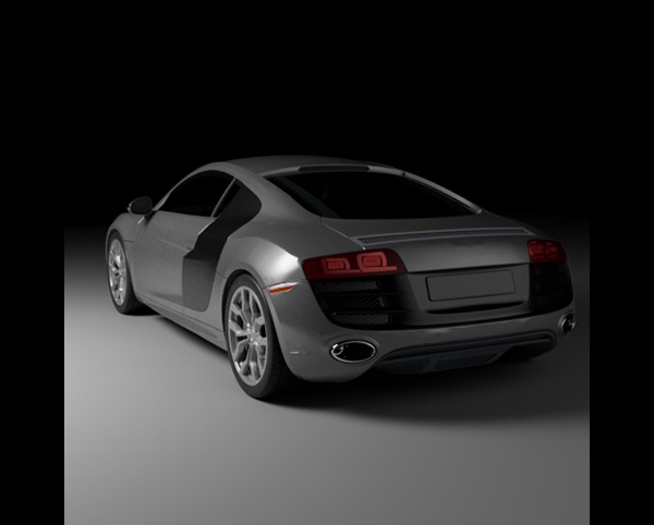

The Audi R8 car model (link at top of page) imported into the lighting rig scenes.

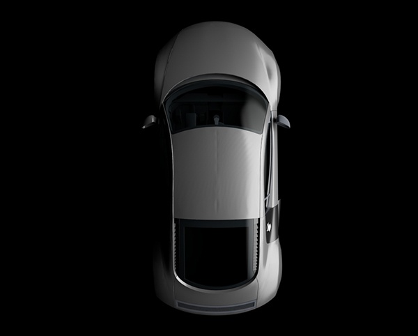

Soft Edge
You can specify a smooth falloff for the edge of the light by using Soft Edge in the Quad Light. This creates a softer look to the specular reflections of the light in the car paint and windscreen.
