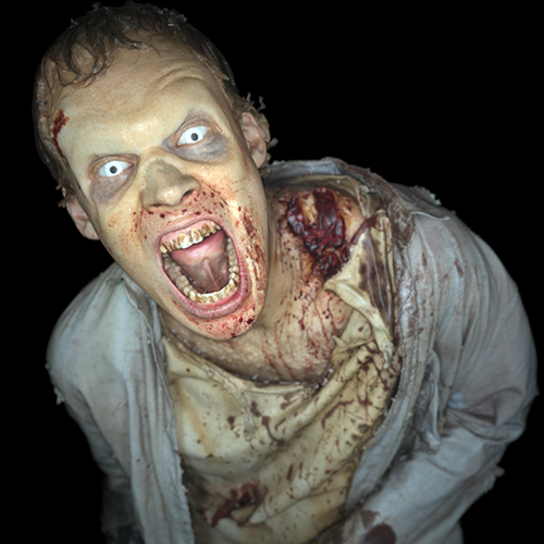

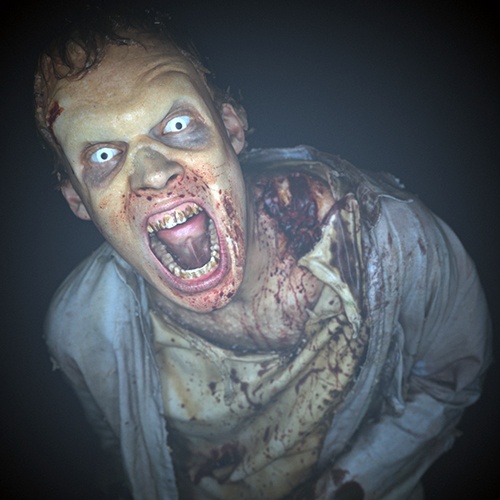

Atmosphere Volume
We can use Atmosphere Volume to add a creepy atmosphere to the scene.
No Atmosphere Volume Atmosphere Volume
  • To add some volume scattering to the scene, first, create a Shader in the SHOP. Double click to enter the VEX Builder and Tab-type (Custom > Atmosphere Volume. Connect the output of the atmosphere node to the atmosphere parameter of the environment output node.
  • In the Main tab of a Render Output, connect the required Shaders to the Environment parameter.
  • Increase the Density attribute of the Atmosphere Volume slightly to around 0.005.
