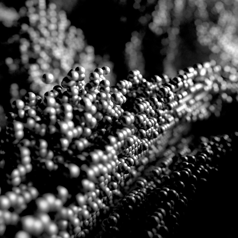

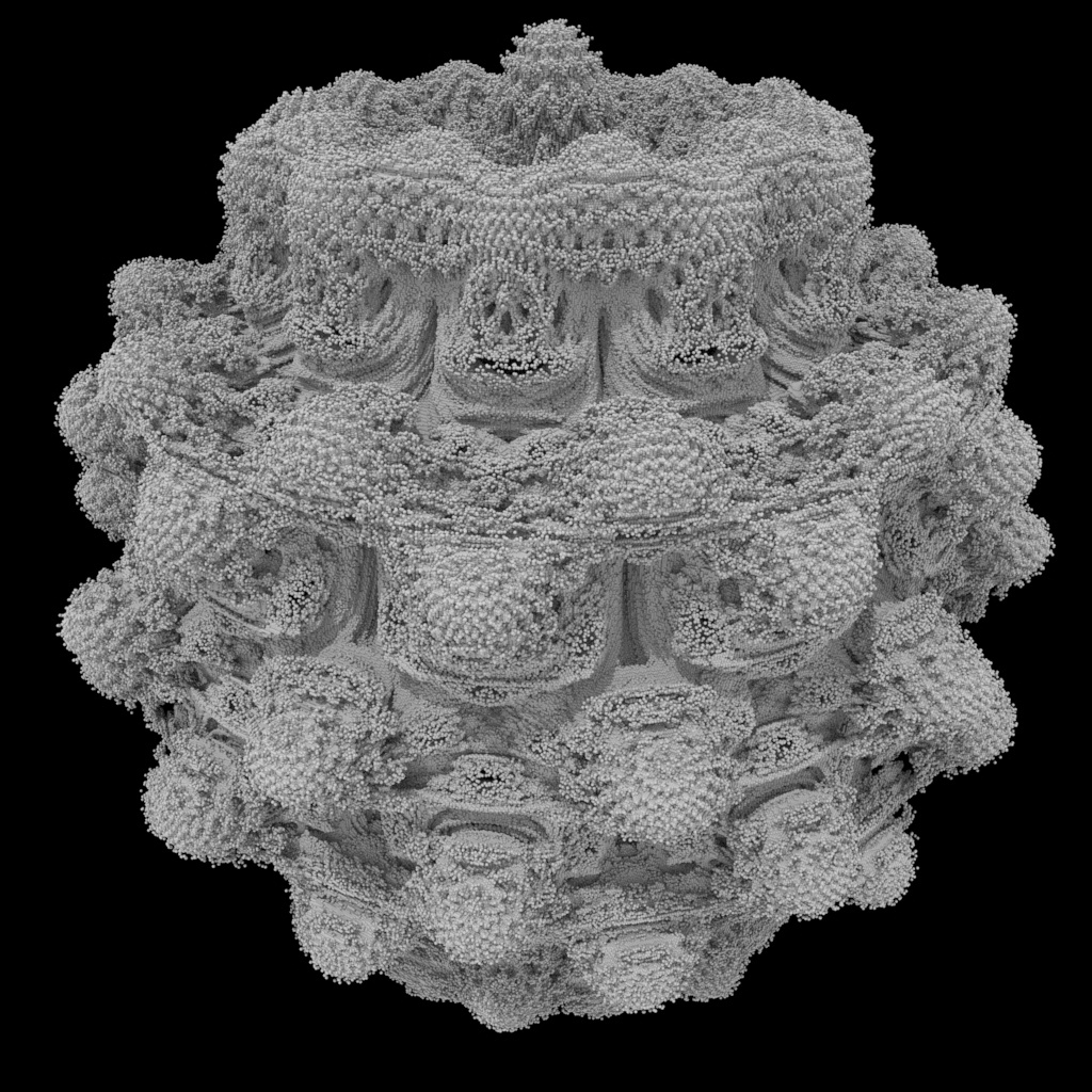

Grid Size

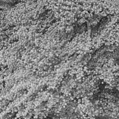

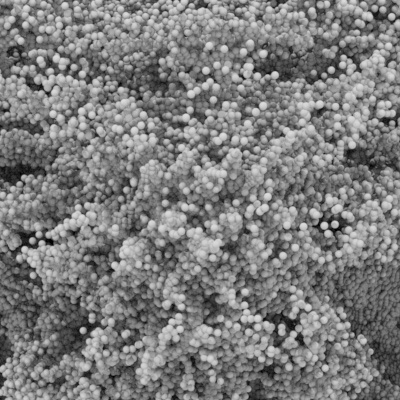

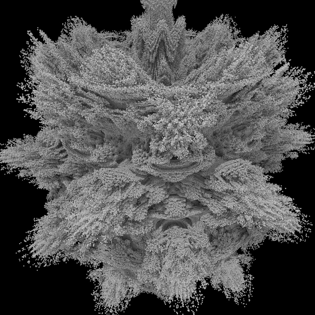

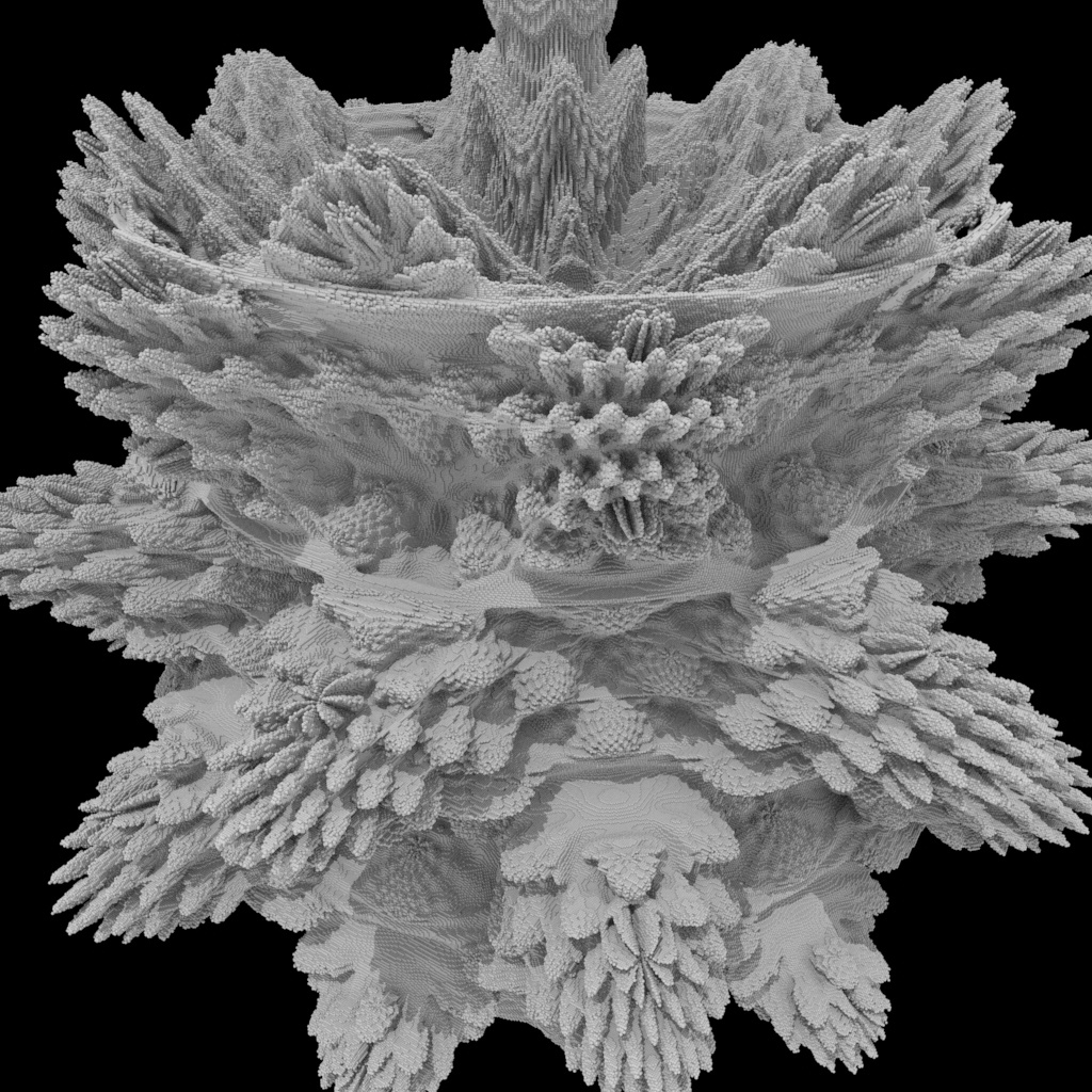

Gridsize is the number of cells in the grid, i.e., 800 x 800 x 800.
To increase the resolution of the Mandelbulb, you will need to increase the grid size. Higher numbers will create more spheres. Be careful when increasing this number, as memory use and render times will increase.
| Gridsize: 400 | Gridsize: 800 |

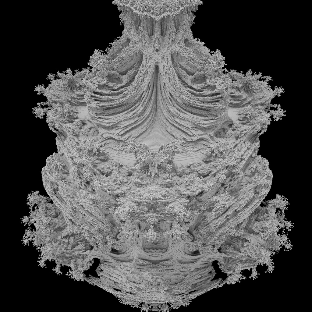

Max. Iterations
Maximum number of iterations to try. If, after this number of iterations, the point is still inside a sphere of radius 2, then it is assumed to be a prisoner point.
| Max iterations: 3 | Max iterations: 9 |

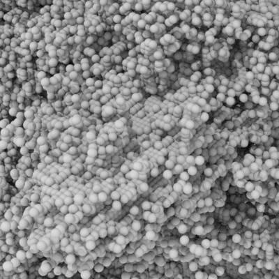

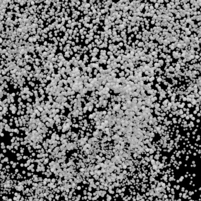

Sphere Multiplier
This is a multiplier for the radii of the spheres in each cell; larger spheres will blend better, but will make it 'puffy', smaller spheres will show the grid more.
| Spheremult: 1 | Spheremult: 2 |

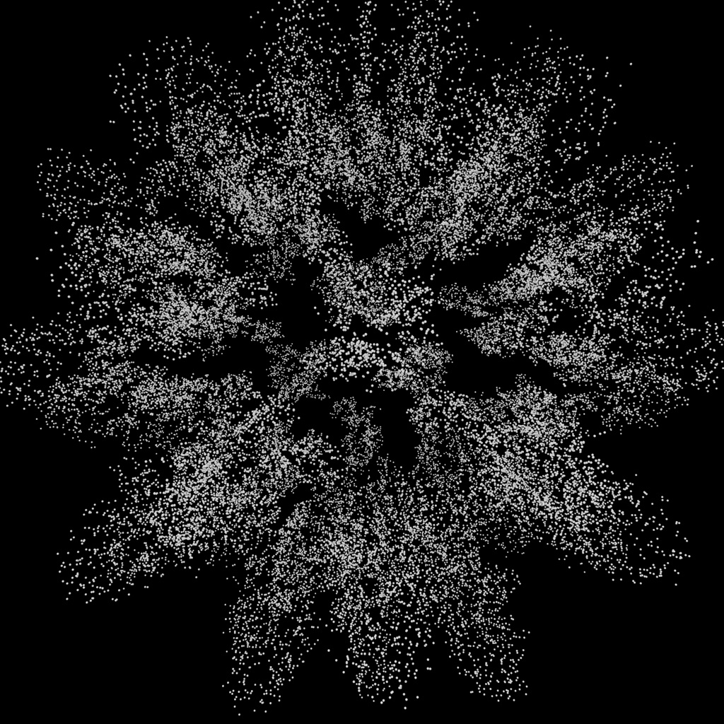

Orbit Threshold
If a point doesn't iterate out farther than this distance, it is assumed to be well inside the Mandelbulb and will not be added for rendering; this clears out a large hollow area in the center of the Mandelbulb, making the geometry a bit lighter.
| Orbitthresh: 0.05 | Obritthresh: 2 |
