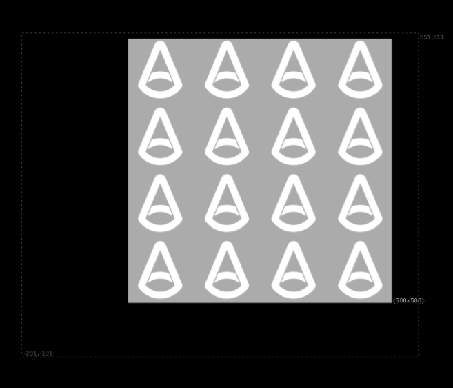

Overscan
Overscan extends the render region beyond the regular image coordinates by a specified number of pixels. It can have:
  • One value such as 10 to specify an equal margin on every side.
  • Two values, such as 10 5, to specify the top/bottom (first value) and right/left (second value) margin.
  • Three values, such as 10 5 2, to specify the top (first value), right/left (second value), and bottom (third value) margin.
  • Four values, such as 10 5 2 1 to specify the top, right, bottom, and left margins, respectively.
E.g. a ten-pixel overscan for a 640x480 image in all directions can be achieved with options region_min_x, region_min_y, region_max_x, region_max_y of -10, -10, 649, 489. The example below shows a pixel value of 10, 50, 100, 200 (top, right, bottom, left) in the 'Overscan' field:
Overscan set to 10, 50, 100, 200, and the result viewed in Nuke

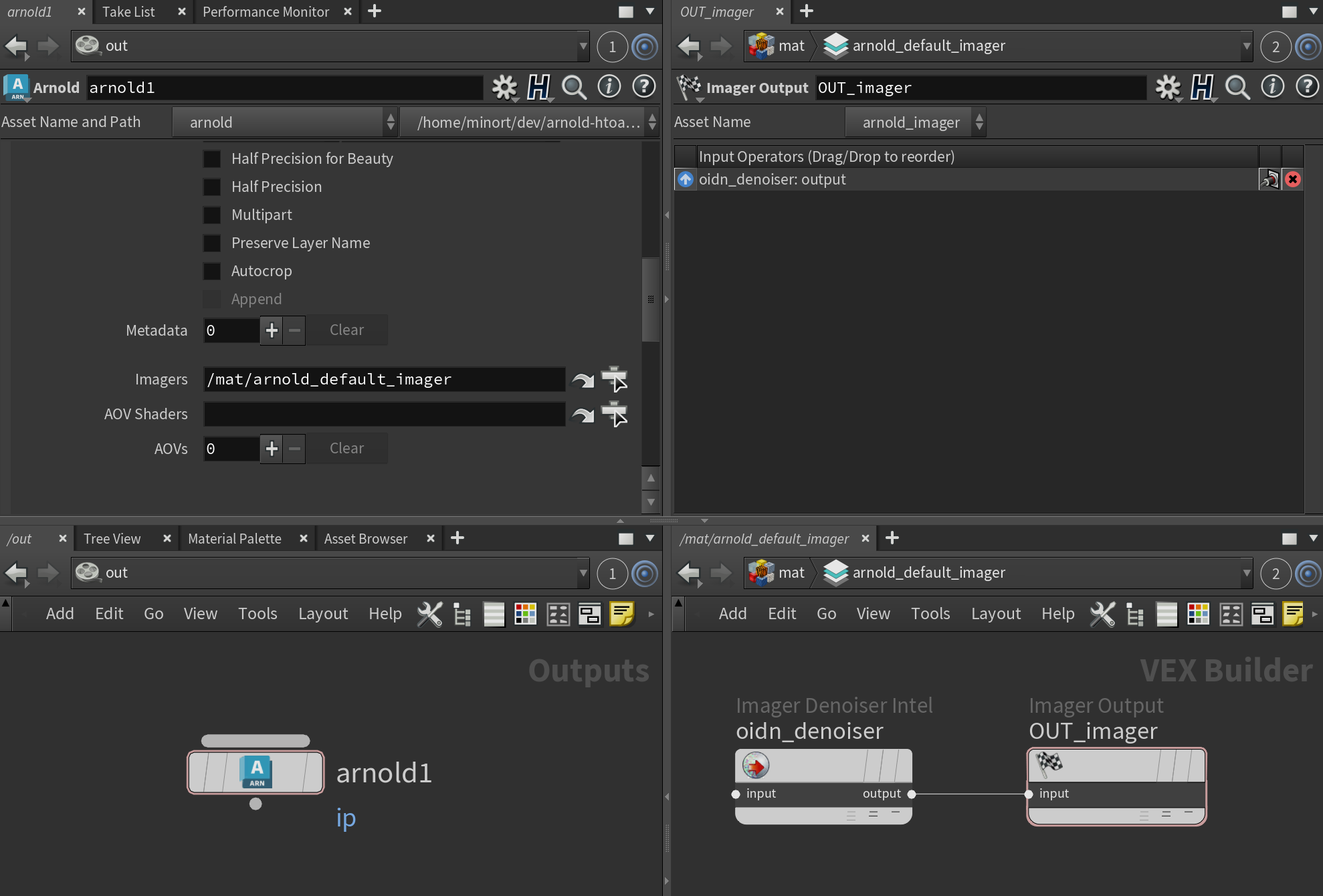

Imagers
By default, the Intel ® Open Image Denoiser imager (OIDN) is automatically added to new scenes (existing ROPs are unchanged). You can disable the default denoiser by setting the ARNOLD_DEFAULT_DENOISER environment variable (to false, off, or 0).
