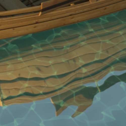

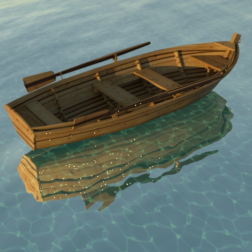

This scene consists of a boat model on a plane that represents the sea. Both models have Standard Surface shaders assigned to them. As you can see in the image above, there are many 'fireflies' in this scene. In this situation, they are caused by the bright sun disc from the Physical Sky shader that is connected to a Skydome Light. This kind of noise is difficult to remove by simply increasing the number of samples in the render settings. However, there are several ways to overcome this type of noise. We will work through some of these methods below.

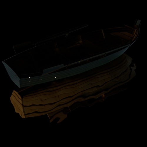

One way to identify where the fireflies are coming from is to render the scene using AOVs.
- Go to Outputs and tab-create an Arnold ROP.
- Select the Arnold ROP and go the Properties> Output tab. Create AOVs for specular_direct, and specular_indirect.
- Render the scene and open the AOVs.
We can instantly tell that they are coming from two places:
- The boat shader which has some specularity.
- The sea shader which also has some specularity.
When rendering out these AOVs, the fireflies are clearly visible:
| Clamp Max Value 10 (default value) | Indirect Specular AOV (fireflies visible on boat) |

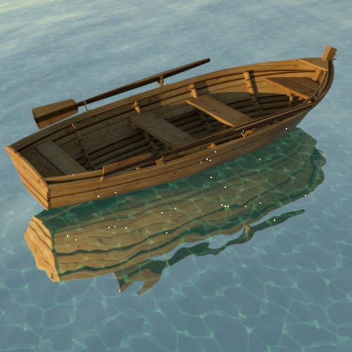

Specular Roughness
In some situations, increasing the Specular Roughness may help to reduce fireflies as it is effectively creating a larger, softer specular hi-light. Increasing the Specular Roughness of the Standard Surface shader that is assigned to the boat reduces the number of fireflies. However, in this instance, there are still some fireflies evident when using this method.
| Low Specular Roughness value | Specular Roughness: 1. Fireflies have been reduced but are still evident. |

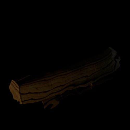

A better method is to assign a simpler shader for Specular and diffuse rays using a ray_switch shader.
- Assign a Ray Switch shader to the boat.
- Connect a Standard Surface shader to the Diffuse Reflection and Specular Reflection rays of the Ray Switch shader. Make sure that the Specular Weight is set to 0. This will force specular and diffuse rays not to evaluate the specular component of the shader, which is the source of the fireflies.
- Connect the boat's Standard Surface shader (with Specular Weight) to the remaining attributes (camera, specular reflection, transmission, and shadow).
When we look at the AOVs we can see that the fireflies are not visible:
| Indirect Specular AOV | Rayswitch Beauty (no fireflies) |

Another option is to clamp the output value of the pixels in the scene. This control will clamp pixel samples to the specified maximum value for all shaders in the scene. The images below show the effect clamping has on the fireflies. A value of 1 eliminates the fireflies completely. However, it also removes any dynamic range from the render.
| Clamp Max Value: 5 | Clamp Max Value: 1 (fireflies have gone) |
