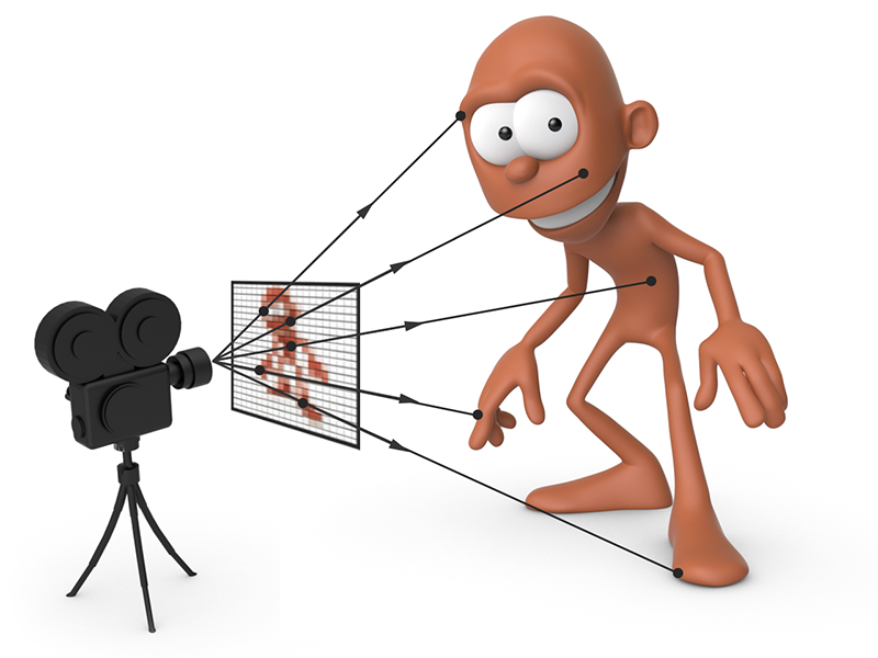

When rendering an image, Arnold must determine a color value for each pixel by examining the scene. Arnold achieves this by sending out a number of rays from the camera's position until they hit an object in the scene. Every time a ray hits an object, it will perform some calculations that will eventually return a piece of information about the object (its color, for instance). This process can basically be described as 'sampling' the pixels in the virtual camera's image plane.

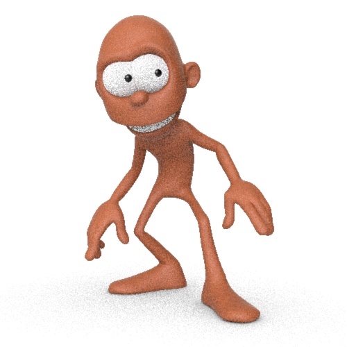

Renders computed with too few samples in each pixel can be noisy. Increasing the number of samples per pixel gives a less noisy image which better represents the actual scene. The images below show a comparison when increasing the number of Camera (AA) samples in a scene. Not only does increasing Camera (AA) samples reduce aliasing noise, but it also adds more secondary ray samples which also reduces noise in the lighting.
| 1 Camera (AA): 1x1=1 sample per pixel (image appears noisy) | 6 Camera (AA): 6x6=36 (noise is reduced) |

So, what is camera sampling? Basically, a number of rays are shot from the camera through each required pixel of the rendered screen window into the scene. These are called 'primary rays', but sometimes they are referred to as 'eye' or 'camera rays' (Camera (AA) (anti-aliasing)) as they are cast from the rendering view. Sometimes they are called 'pixel samples'.
The Camera (AA) value controls the pixel supersampling rate or the number of rays per pixel that will be traced from the camera. The higher the number of samples, the better the anti-aliasing quality, but the longer the render times.

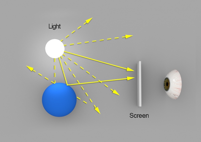

Direct lighting rays can be described as rays which deal with lights. These rays travel from a position in the scene toward the various light sources. These rays determine if a surface is in shadow, and if not, lighting information can be calculated.
Noise from lights can sometimes be difficult to diagnose, particularly if it is a light with a large area or size. In these cases, it can sometimes be mistaken for indirect diffuse noise. This highlights the necessity for testing different noise ray types. If the issue is shadow noise, then we can simply toggle ignore shadows in the Arnold render settings, and the noise will completely resolve. The images below show how a light is traced in Arnold.
| Some light rays hit an object while others do not | Light sampling in Arnold |

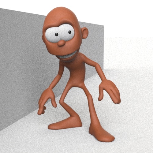

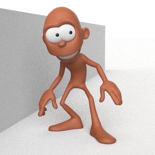

The same noise problems described earlier can occur with direct and indirect rays. Noise from direct light sources usually appears in specular highlights or in large, soft shadows from area lights. If this is the case, the number of light samples needs to be increased. The images below show the difference in the shadow noise when increasing the number of light samples from 1 to 3.
| 1 light sample. Very noisy. | 3 light samples. Noise is improved. |

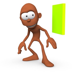

Diffuse Ray Sampling

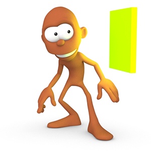

| Indirect (diffuse) lighting from emissive green cube | Direct lighting only (Diffuse samples: 0) |

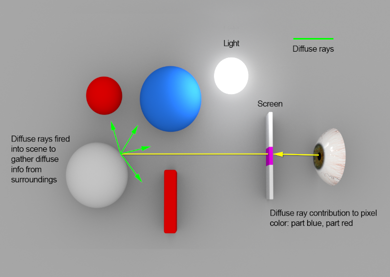

Indirect Diffuse rays are rays that interact with objects and their surface shaders. Therefore, rays travel in the scene in directions determined by the shader assigned to the object. Transmission rays travel through objects. When a ray hits a reflective object, such as a mirror, only one reflection ray is traced from that point in a direction determined by the incoming ray. In contrast, diffuse rays are sampled randomly over the hemisphere around the hit point.
Diagram showing how diffuse rays are propagated in an Arnold render

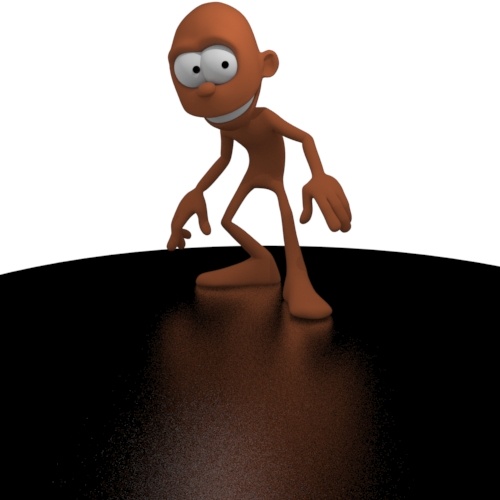

When rendering glossy specular surfaces, noise can also be a problem, as with diffuse rays. Bright hotspots can cause noise in indirect specular samples. For example, wide specular reflections of small, bright lights. If the issue is noise in a specular highlight, it needs to be confirmed that the source is the direct light and not a secondary ray type (such as specular). This is easy to achieve by setting the Diffuse Ray Depth, Specular Ray Depth to zero (this essentially turns off all global illumination). If the noise is still there, we know it is the direct specular component of the illumination model. In most cases, it can be resolved by increasing the number of specular samples.
| 1 (insufficient samples) | 4 (sufficient samples, noise is reduced) |

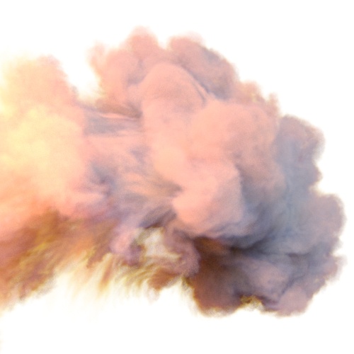

Volumes

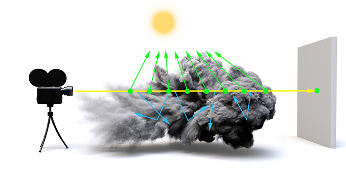

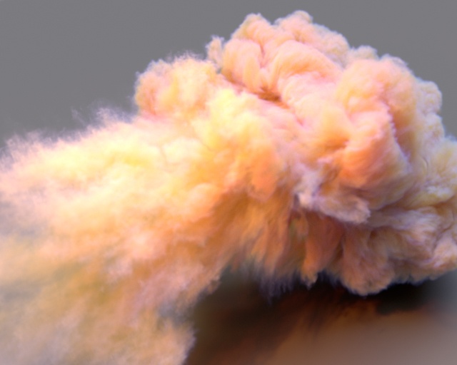

When sampling volumes, direct Camera (AA) rays sample the volume multiple times as they travel through it. Indirect rays (Volume Indirect) behave similarly, sent multiple times as the ray 'steps' (volume Step Size) through the volumetric object. Therefore, sampling a volume usually takes longer to calculate than sampling a surface.
Volume sampling. Direct lighting (green). Indirect lighting (blue).

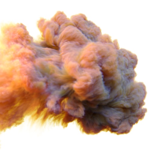

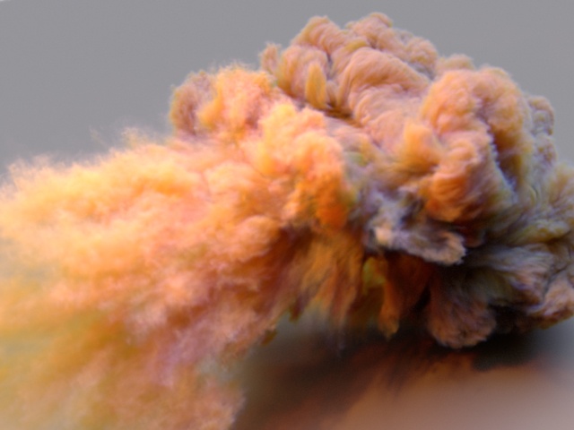

At each step the ray travels, it evaluates the shader and accumulates the density of the volume. When these density values become more erratic throughout the volume, nearby rays can calculate substantially different values, introducing noise into the render. In this case, it may be necessary to render using more light volume samples or to reduce the step size in the volume. Even with low sampling values, it can be expensive to render clean images with volumes.
| Light volume samples: 1 | Light volume samples: 6 |
There are three things to consider when rendering volumes; raymarching, direct light, and indirect light sampling, all of which have different sampling settings.

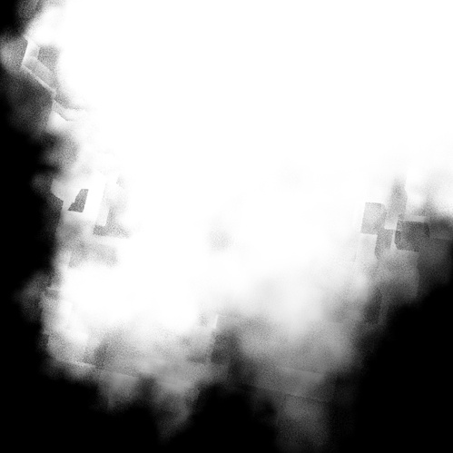

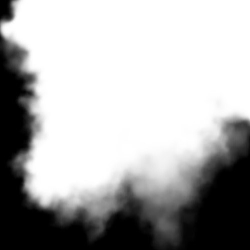

The Step Size of the ray marching process. Too low a sampling rate here will cause the volume rendering to miss small details in the volume, making them noisy, making them thinner than they should be, or making a bad estimate of the exact position of the 'surface' of a 'solid' volume like a pyroclastic cloud. A bad Step Size has a snowball effect that can make the rest of the sampling process noisier. This is pretty easy to test by looking at the alpha channel, or by adding some emission to the volume and turning off all lighting. If the emission/alpha channel is noisy at the desired Camera (AA) setting, then the Step Size is probably too large.
| Step Size correct | Artifacts appear in the alpha when the step size is too large |

Volume ray depth

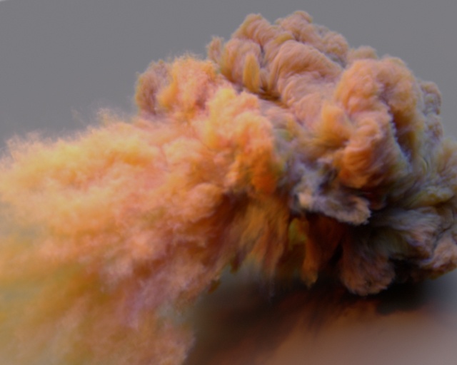

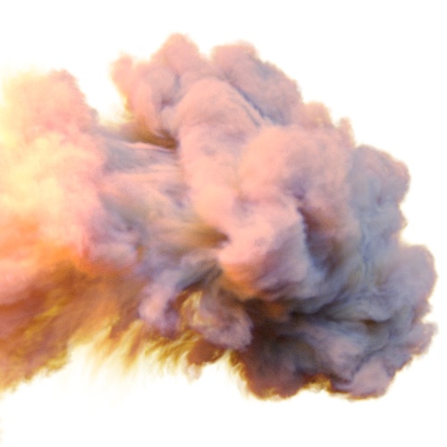

Increasing the Volume Ray Depth can make a dramatic difference to the appearance of a volume. However, be aware that increasing the volume ray depth will increase the number of multiple scattering bounces within the volume (defaults to 0), and therefore render times will increase significantly.
| 0 | 6 |
