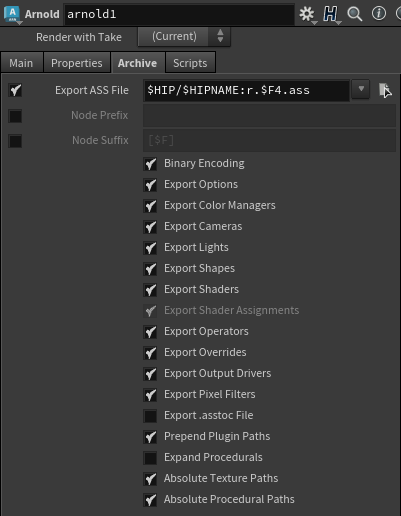

Archive - Arnold for Houdini
Export the scene as an .ass/.usd file to be rendered outside Houdini with tools such as kick (a multi-platform, command-line utility) or to be used as procedurals.
Important:
Exporting to .ass/.usd files is not available in Houdini Indie versions lower than 18.0.460
