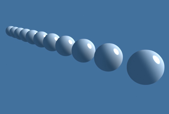

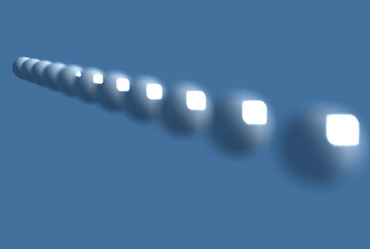

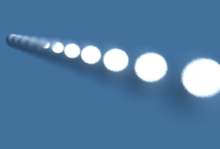

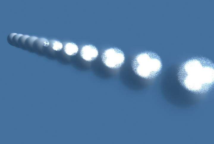

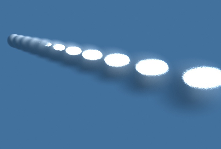

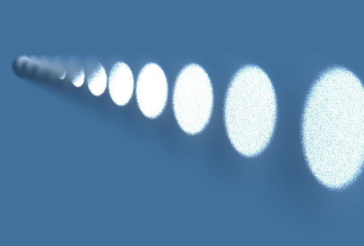

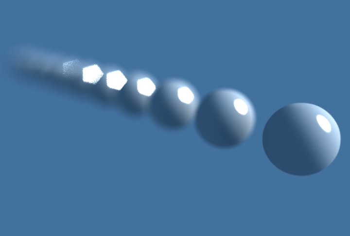

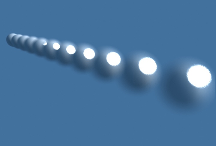

The following images demonstrate the effect of different camera depth of field values. The examples below use a sphere that has a radius of 1 (remember that scene scale size can affect the DOF values that you use).
| No depth of field | Size 0.01. Aspect Ratio 1 | Size 0.25. Aspect Ratio 1 |
| Size 0.5. Aspect Ratio 1 | Size 1. Aspect Ratio 1 | Size 1. Aspect Ratio 0.5 |
| Size 1. Aspect Ratio 2 | Size 0.5. Aspect Ratio 1. Blades 3 | Size 1. Aspect Ratio 0.5. Blades 3. Blade Curvature -5 |
| Size 1. Aspect Ratio 0.5. Blades 3. Blade Curvature 0.5 | Size 1. Aspect Ratio 0.5. Blades 4 | Size 1. Aspect Ratio 0.5. Blades 4. Rotation 45 |
| Distance 8.5. Size 1. Aspect Ratio 0.5. Blades 3. Blade Curvature -5 |
